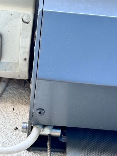

My old automatic outdoor sun shade is not responding to the remote and I’ve been living in the dark as it’s stuck in fully down position.
I’ve been calling so many companies if they can help me fix the problem but they all declined as they don’t use the brand I have.
Now I just want to take it down so I can get some sunlight but I can’t find a way to remove the cover.  I dont know how to remove these grey pins with a hole in the centre. No screw drivers work as the hole is completely hollow.
Does any genius know what kind of tool I need to remove these pins? Please help

I'm no genius @648593, but the image on my phone looked like a Hex-head.
Have you tried a Hex/Allen Key?
But now - tying to magnify it - a large pop-rivet?

There is a good chance that they are pop rivets, which need to be drilled out. Take a drill bit slightly larger than the hole and drill through the centre. This will remove the head of the pop rivet and disengage it.
Given this is an electrical device, I'd encourage you to enlist the services of a handyperson to complete any work on it. If you don't plan on having the unit repaired or are unable to find someone to do so, you might like to consider cutting the sunshade off.

You are a genius! Thank you so much:)
