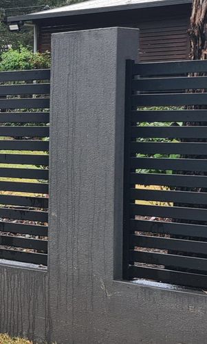

Hi, planning to change the colour of the external render walls from dark grey to white/neutral colour.
How do I repaint? Do I need a coat of primer or do I just do 2 coats of paint on top the existing paint?

As it looks like the previously painted surface is in fairly good condition, you can simply paint 2 coats of Dulux 4L Vivid White Low Sheen Weathershield Exterior Paint over the existing paint in your chosen colour. If you find that the colour is still poking through from beneath, simply apply a third coat.
I'd suggest using a high quality, long nap roller such as this Uni-Pro 270mm 21mm Nap Masonry Roller Cover and then cutting in using a Monarch 50mm Cutting In And Framing Synthetic Paint Brush. You can also use masking tape and drop sheets to protect the horizontal slats and any areas where you do not wish to get paint.
This will give you a fresh new look with relative ease.

The Dulux Weathershield does not require additional primer over already painted surfaces. If you wanted to ensure there is no colour poking through, there is no harm in using a primer such as Dulux 1Step Prep Primer, Sealer & Undercoat, but it is not a necessary step and will increase the cost of the project.
I'd suggest giving the surface a good clean with hot water, sugar soap and a Heavy Duty Scrubbing Brush before applying the paint.
Wash&Wear® +PLUS Super Hide Low Sheen is an interior paint, so unfortunately it can't be used in this application.
The Taubmans All Weather Exterior Paint is a similar alternative that is also self priming and can be used in this application if you prefer.

After pressure washing the walls, how long do i need to wait before painint on it? Is it ok to start the paint next day?
Also, any recommendations as to what shade of white is good for external walls which get full sun most of the days?
Re: Repaint external render walls
Hello @pash81
I suggest giving the walls a full day to dry off, an extra day won't hurt either. What's important is that none of the rendered surface must be damp or feel like moisture is still trapped inside. In regards to the colour, there are many variations of white, I propose going to your local store and looking at the colour card samples at the paint department. Take half a dozen cards in different shades of white and place it outside on your fence and see which colour you like. Personally, I would choose an off-white colour so that it's not so vivid and striking.

I would like to paint my external wall which is a similar, just a little more brown. I would like to paint it a dark grey. Would I still need to paint it white first, or can I go straight to dark grey?

I suggest following the advice given earlier by Jacob and that is to clean the surface with hot water, sugar soap in combination with a Heavy Duty Scrubbing Brush before applying the paint.
Make sure that the surface is totally dry and that there are no hidden pockets of water along the fence wall.
Since your wall is already a dark base, you can paint the dark grey directly over the brown paint. There is no need to paint the surface white.
