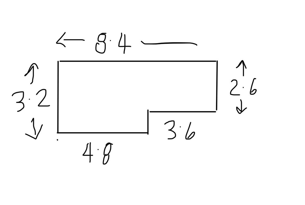

Hey all , need some assistance
wanting to building decking this come spring
H4 Posts 90 x 90
was thinking 90 x 45 for joists/ bearers but open to suggestions
I ve watched Bunnings low level deck videos which uses 2x 90 x45 joined together for bearer , is that required ?

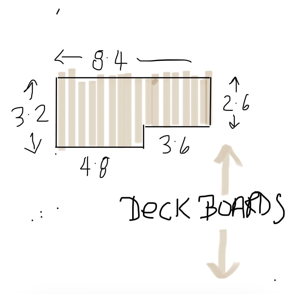

see below diagram for dimensions and deck board direction
I’ve read span tables but wanted confirmation …
Any help greatly appreciated
thanks

Using 90 x 45mm for joists is certaining an option and typically they should be supported every 1000-1200mm by posts. There's no need to double them up for a span of this distance. However, if you wished them to span further, then that is an option, or you could increase them to 140 x 45mm.
Since this is quite a large deck, it would be best to confirm with your local council as to whether building approval is required.
