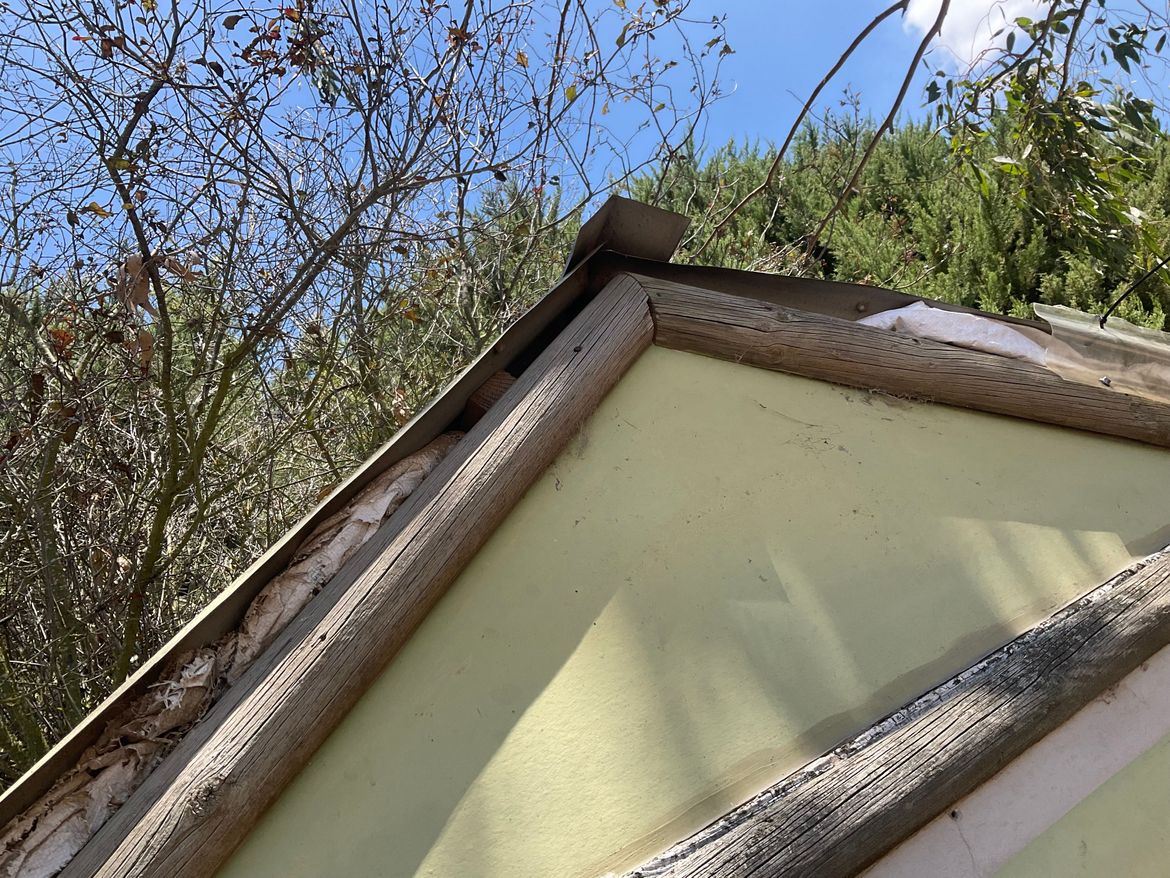

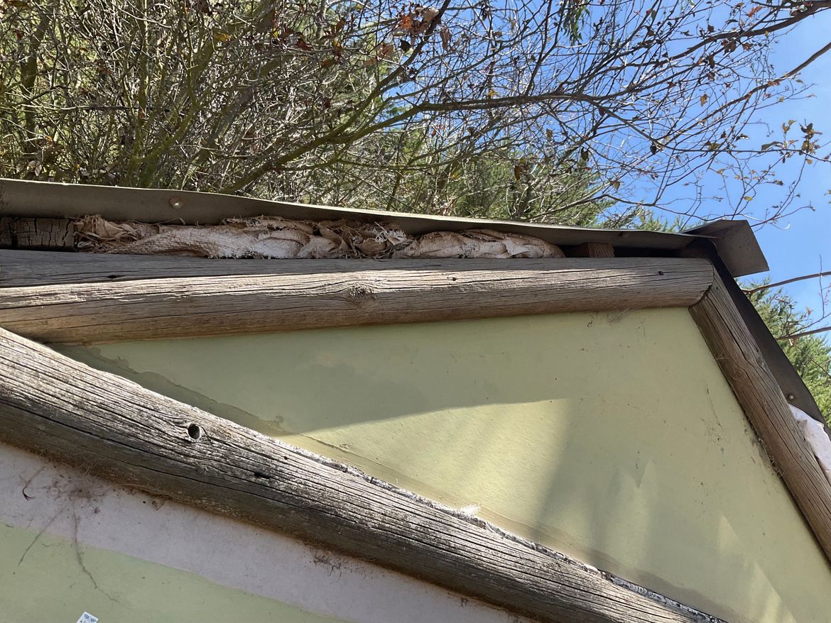

Hi I need help with my cubby house roof it’s for my ducks I need some ideas what I can use IMG_0319.jpegIMG_0318.jpeg
Re: cubby house roof
Welcome to the Bunnings Workshop community @raeleneenglish2. It's wonderful to have you join us, and many thanks for your question about fixing a roof.
I presume you'd like to fill and seal that large gap under the roof sheeting. Using expanding foam to fill any large gaps is an effective way to seal it and prevent drafts or leaks. Once the gaps are filled, adding corner flashing over the foam will help keep the weather out and provide additional durability.
For any smaller gaps, an exterior sealant can be used.
