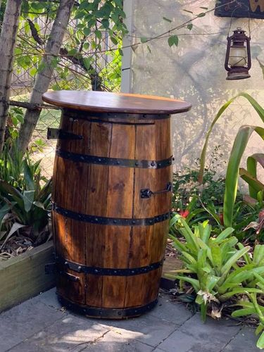

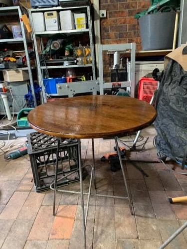

I have just finished making the Wine Barrel cupboard for up the backyard.
I built it so I can store thing in it for the fire pit and wine glass ect.

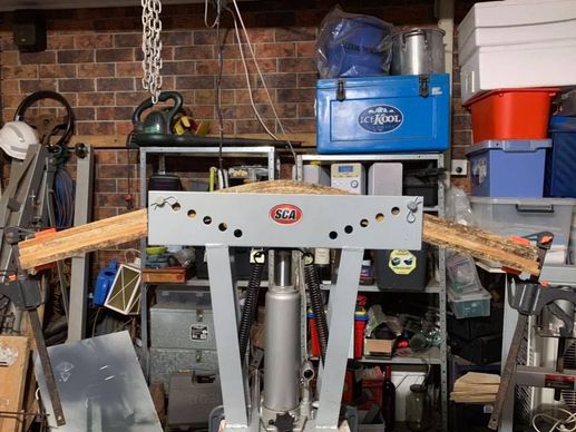

I only started it last year in June 2019, and just used treated pine fence pailings
to make it, pre-bending them, I took a week to bend 4 pailings at a time.
I know it's not the normal way, to make a barrel of bend wood,
and I have never had the need to bent so much wood,
there are about 20 bent pieces, but it seemed to work ok.

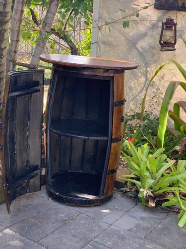

The hinges are just gate hinges, I just bent to suit the angles.
I was making it up as I went. Super happy the way it turned out.
It was able to pick up everything to make this from Bunnings...

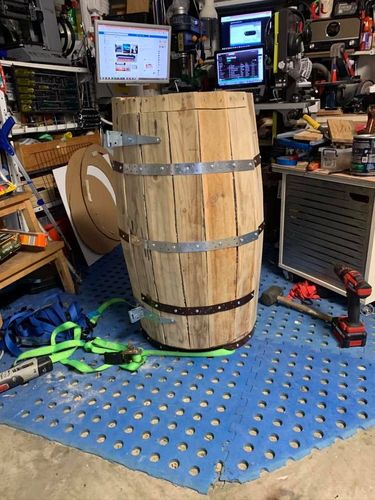

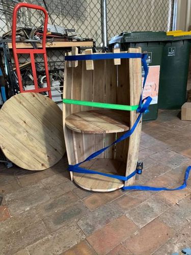

Super thanks Mitchell,
I use Black Silicone in between the boards as silicone is like a glue and good for bonding thing together
and LIQUID NAILS Construction Adhesive for the rest then a 50ml Oak Stain did the whole barrel.
The top and the shelves are also fence pailings all biscuit joined and the tabletop is also fence pailings
with 3mm hardwood ply on the top like a vernier. just black spray paint for the inside and the straps.
The Straps are Strap Brace held on with screws with screw caps to look like studs.
It was a Fun project....
Re: Wine Barrel cupboard
You have blown me away with this @Super_D . 😮
Looking at the first photo, I assumed you repurposed an actual barrel.
Congrats on such an amazing project.
