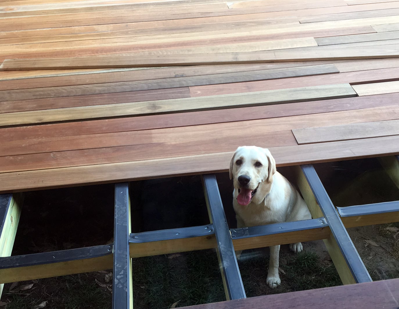

Our new deck is almost complete, but before I can wheel out the barbie I have to oil it. We've gone with spotted gum decking boards and we love the look of them, so we want to use something that won't change the colour of the boards. Any suggestions?

Looks good Darren. Can you tell us why you chose spotted gum? I'm interested to hear people's opinions on spotted gum versus merbau. And what are the width of your boards?
Re: Which oil should I use on my deck?
Thanks @MartyH, the main reason we chose spotted gum is because we like the varied colour of the boards, something a bit different. These boards vary from 130 to 135mm wide.

looking good @Darren
how are you nailing/screwing the deck down?
Thanks, @Dave. We used 10 - 8 x 65mm decking screws (2500 of them to be exact!)
