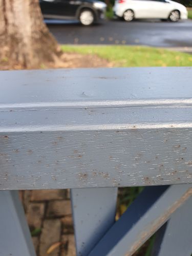

Disaster! The merbau has leeched through my paint job! I primed and painted 2coats, so thought I'd be okay. What should I have some differently?
And now, should I just put on another coat or will it happen again?
Thanks!
Hello @Bluetooth
I'm sorry to hear that you've tannin staining pushing through your paint. I suggest using Zinsser 1L Bulls Eye 1-2-3 Undercoat Primer Sealer Stain Blocker. Sand the timber gate lightly and wipe it off with a damp cloth to remove all the dust and debris. Put a minimum of two coats of the Zinsser primer. Please make sure that the first coat is totally dry before putting on the second coat. Wait for the primer to fully cure and then paint it with the regular paint you used on your fence.
