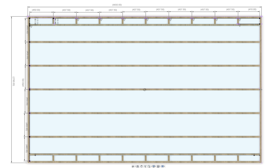

Back to my parents back deck. Here's an image of my plan so far drawn on cad. Top of the photo is north, House starts from the west side.
Pictured below (to scale)
Frame = 4430 x 2780
Picture Frame style
joists = 70 x 35
supports = L and Pedestals
West joist/bearer secured to brickwork of the doorway with concrete screws(dynabolts?)
Joist hangers for both ends
Deck boards planned for 140 merbau with 3mm gaps
450mm centre to centre spacings
deck lines account for 3mm spacings between boards
N
W E
S
questions-
- I've planned for 70x35 H3 timber for the frame. For span/support would a L bracket or pedestal support every 1.5metres be appropriate? span table linked above doesn't have anything for 70x35 timber.
- Any suggestions for how many rows of noggins?
- For the various fixings, where would concrete screws, dynabolts be most approrpriate? for timber/timber I'll use framing screws rather than nails as you've suggested

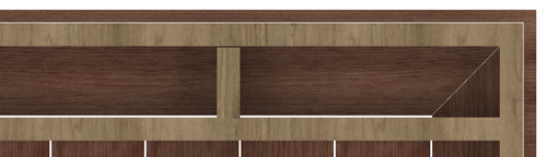

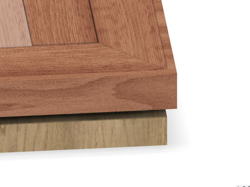

- What's the best practice regarding overhangs when provisioning for fascia plates? Would it be more appropriate to fix fascia plates under the top deck boards or flush to the top as I have imaged below?
- With the supporting pieces for the frame part of the top deck, should a joist run alongside directly along it? or will my noggings pictured below be enough?
anything to consider that I might've left off that'll dictate the build?
feel like I'm getting close to working out a BOM for the project
Hi @Halima,
You'd typically support 90 x 45mm timber joists every 1000mm, so for 70 x 34 (I'd go with 45mm thick), you'd need to support more readily. Something like every 700mm should be fine.
Noggins can be placed every 1000mm between joists and offset on the next row.
Dynabolts or Ankascrews are appropriate masonry fixings. For anything within 100mm of the edge of the slab so with Ankascrews as they are less likely to crack the concrete.
Your plan is looking good so far.
