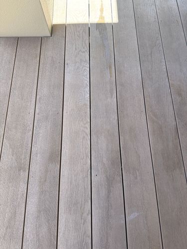

Hello! I just purchased a new house and wanting to clean my decks. I am not sure what material my decks are, can anyone help?

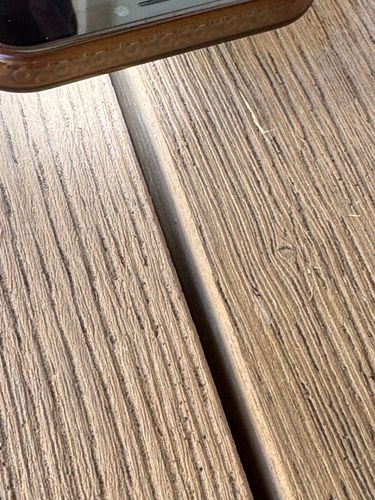

I am 99% sure based on the second image that it is composite as this is not what natural timber looks like. You can confirm this by looking at the end of a board. If it is timber, there will be visible growth rings, if it is composite there won't.
Check out the Ekodeck Decking Care & Maintenance Guide.
Ekodeck, which is our main composite decking supplier, recommends using hot soapy water and a deck scrub brush to scrub the deck, before washing it of with a pressure cleaner with a fan nozzle attachment.
