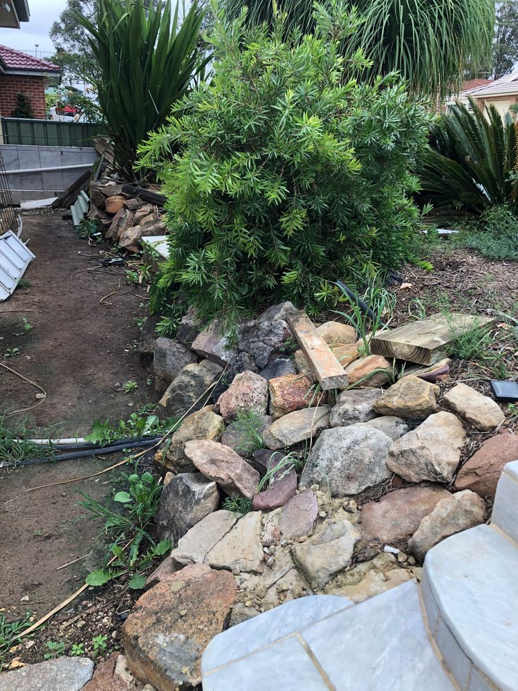

Thanks for any assistance. We got a guy to dig a trench at the lower part of a small embankment, along the dirt driveway to the drain. He only had one bucket size so really the trench was too wide to begin with, about 40-50cm. The trench is clay. Now each time it rains , here and there small areas of that embankment wall in the trench, collapse. What would be the best solution to ensuring the trench never collapses?

just using a photo I have on website.
For you steeper wall areas. Simple rock wall with black woven weed mat behind supports an embankment (weed mat is cheaper than Geo cloth given you have a reasonably long section to do.
Use the weed mat plastic to line the trench fully including side walls. any excess simply fold under itself on the sides.
The rocks bed into the wall on top of weed mat and all the recent rains didnt budge them or allow erosion. Note the dirt path no erroision tracks after 2 years todate.
The dish part of the trench use weed mat with broken brick on top finish off with nicer gravel as a top layer. Including more of the crushed drive way rock it will settle in to the top of the brick work and still allow water to flow.
By all means run a ag pipe sitting in the middle of the bricks but I dont think it will benifit you much more than broken bricks ( the kind with holes in them) as the water always finds its way down stream
simple rock embankment just piled
