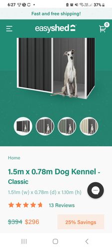

Hi, I have ordered this dog kennel and wanting to have it secured to a small deck. There is no floor for this kennel so i thought a slightly raised deck 1.5m wide (kennel is 1.5m wide) and at least 1metre of deck in front of the kennel, kennel is .78 deep. My DIY skills aren't amazing.
Would a couple of goodtimes modular decks be suitable with some outdoor plywood over the top I thought ply might be cheaper than the premade deck panels from goodtimes decking. I might have this set up on my concrete patio or half on the grass/patio. Any easy ways to do this please? I like the qualities of eko deck but it looks expensive.
