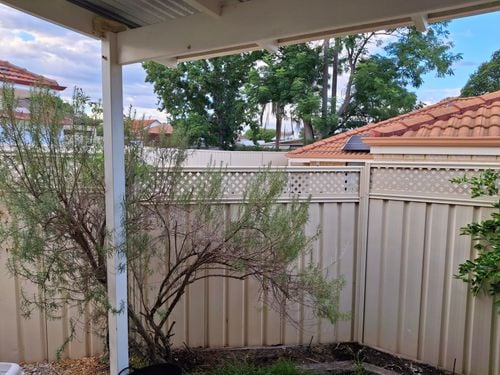

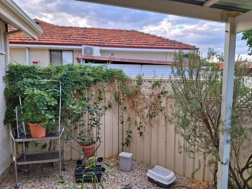

I'm looking for ideas on how to provide good screening from neighbours. Currently from our kitchen and underneath the patio, we can see right out to the neighbour's driveway and we're wanting a little more privacy.
Our current colorbond fence already has a 300mm topper extension. I was thinking of growing hedges along the fence, such as a lilypilly, but afraid that its roots would be too close to our house. My other thought was that we don't know if there are pipes under the gravel; if you look closely at the bottom of the pergola pole, that's where our hose pipe is.

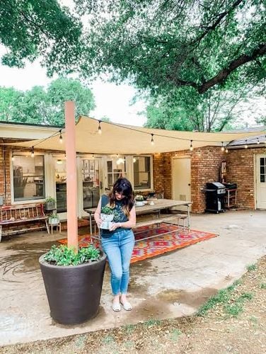

Another idea was to use S-hooks and hang wire mesh panels for height on the existing fence and then grow a vine along it such as Jasmine. But again, I'm thinking that depending on how heavy the panels are, the fence might not be able to hold the weight.

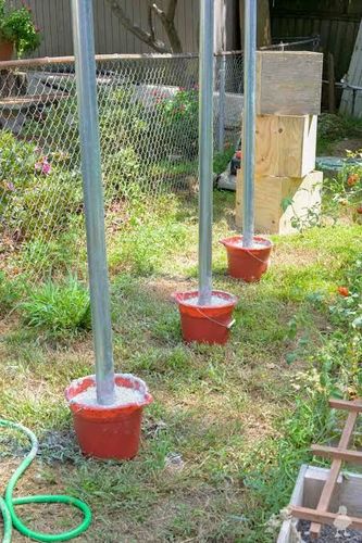

A third idea to mitigate any damage to underground pipes was to get create poles by cementing them into deep buckets and connect either the wire panels or trellis along it.
I'm also open to other low cost ideas!
I've added photos of the space and of ideas I've taken from the net.

I think if they are planted along the fence line, then Lilly Pillies are a good option. From your images, it doesn't look like it would be too close to your house, but I wouldn't advise planting them right up against the wall. If you weren't comfortable planting them in the ground, then some extra-large pots might be a good option.
Steel posts could also be a good option to hang bamboo screening or shade sail from. Ideally, you would concrete them into the ground, but I understand your concern about damaging underground services. If you check with your building plans, align the posts closely with the existing fence posts, and dig carefully, then you should be able to avoid damaging underground pipes.
If you are not comfortable with this, then concreting posts in buckets could be an option, but in high winds, there is a risk that they could fall over.

Good Afternoon @diylife Thank you for sharing this. So many people have that same problem about seeing the neighbours and wanting privacy. I’m the same. I love the ideas @JacobZ has given. It looks like a small backyard from the photos. I personally wouldn’t plant straight into the ground.
This is just my opinion but what I was thinking is :
Clear the whole fence line, removing that creeper and straggly shrubs that are currently there.
You could add Raised Garden Beds and plant a hedge that will grow a bit taller than the fence to block out the neighbours. If you don’t want to use raised garden beds then you could also use large rectangular planters that will do the same thing. I also like the idea of Screening as well. It gives you a few options and I am sure that other Workshop Community members will have some great suggestions for you too. Good luck and stay in touch. 🌿🙂

I would go for larger metal garbage can sized pots for posts and use stones/smashed concrete for the posts. less likely to fall over and they dont look top heavy. You could then do the whole wire trellis up higher. Note vines can be pretty heavy so maybe a solid beam between the posts in garbage cans?
So GC post, beam, GC post, beam but stepped so it overlaps teh last one, GC post and contine along teh fence line. If you wantto stop wobbles or the wind all you need as another GC post out at right angles and a beam from the right angle post back to the straight run.

Looking at your first backyard photo, there doesn't appear to be a lot of open space. So, anything you place in front of the fence-line will shrink it further. The obvious solution is planting tall-ish trees or shrubs as suggested, but then there will be the issue of on-going maintenance. There are many varieties of bamboo that will retain their height once cut at the desired height. A friend of mine has a small 6m x 6m backyard and with regular maintenance they look great and ideal as a fine tall privacy boarder. But they do grow new shoots from the ground, so these will need to be cut every few months to maintain the thin wall.
