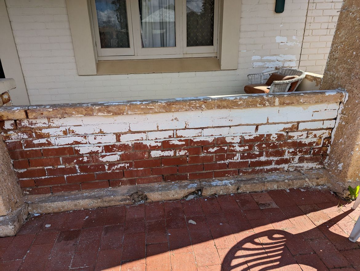

i have a wall where the mortar has come off and there are some cracks too.
as shown in the image attached.
 should i render the section and also the sides of the veranda. and then paint it. i will be repainting the whole house. or do re-pointing instead.
which is easier ? also i will be looking to paint the veranda a different color to the house to make it pop

Thanks for sharing your question about your brick wall. My vote goes to re-pointing the bricks, although it may be detailed work this type of repair will dry relatively quickly, and you can paint the brick surface much sooner.
The brick surface will allow it to blend in with house even if you paint it with a different colour. I understand that you want the veranda to stand out and that is definitely achievable, but what you don't want is for it to look out of place. An overly modern finish could contrast badly with the character of the house.

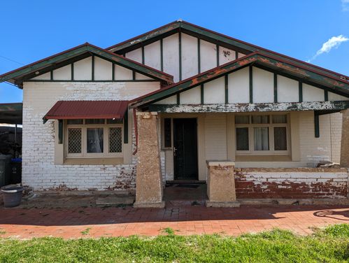

Would it be possible for you to post a larger photo of the front of the house even in its unfinished state? I'll be more than happy to do a quick photo manipulation for you so that you can see the difference between a rendered wall and a brick surface wall.

 this is what the front looks like

Another vote for repointing from me here.
@EricL will be back on the site after the weekend, and I trust he'll be excited to put those manipulations together for you.

I've done a basic photo manipulation of the house so that you can see the difference between the brick wall rendered and not rendered. Please have a good look and tell me what you think.
