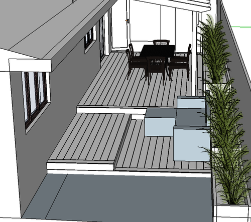

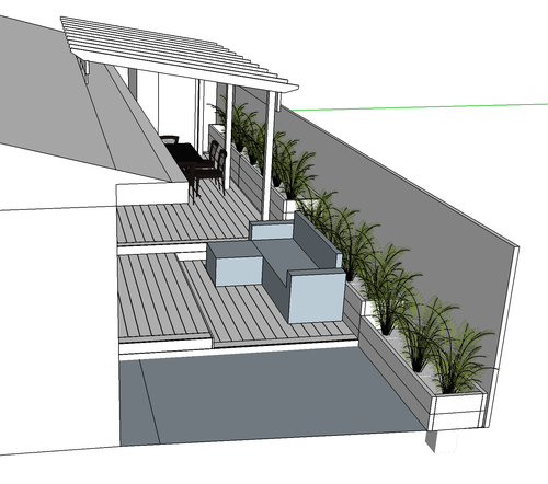

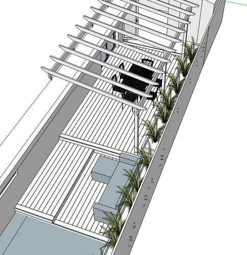

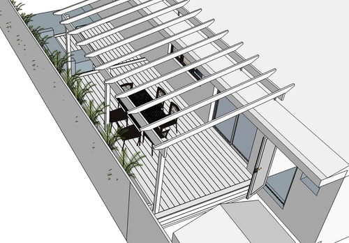

I'm busy planning my deck and pergola. This is what I'm thinking at the moment.
I thought the 3 layer deck would be nice (total deck length is 9m, pergola length is 6m, highest deck is 35cm above ground).
I was thinking of using the lowest deck to put a lounger couch on, but not sure it takes up too much space. Also, not sure the planter box along that deck makes sense either? It's around 45-50cm wide.
In the designs, I've staggered down the planter boxes. The deck is 3m wide at the top, and 3.15m wide in the lower part (from house brick to planters).
The part without deck goes off into our garden.
Fence is colourbond 2m above ground (so 1.7m above the higher deck).
I also have no idea where to put the BBQ or if I should build in a BBQ area, or simply use a portable to make the space bigger.
(I can add some screens without plants if that helps).
Here's some designs
Would love your thoughts.

That design is looking great @Itai.
I like the planters as you have them now, and some decorative wall art behind them would add interest to the Colorbond fence. Is the pergola going to be covered with sheeting? If so, I would encourage you to try working in a bbq area under it. There's nothing worse than cooking a BBQ in the blistering summer heat or having a thunderstorm roll through and ruin everything.

Yes, I will be covering it. I'm looking at something like this to cover with: https://www.bunnings.com.au/ez-glaze-3-0-x-1-2m-x-3mm-grey-polycarbonate-roofing_p0117234 ... So the space feels nice and open!
And yes, I totally agree, I should put the bbq under the cover. But I'm not sure where is the best fit. The large window there, I am planning to put a nice piece of timber panel there to create a bit of a breakfast bar / serving window. Also, it wouldn't be a great place for a BBQ considering the smoke going into the house. I feel like the best place might be by the start of the deck, near the door, perpendicular to the planter, with some nice screening. But that means you see the side of it from inside the house. I could potentially put it against the planter boxes on the corner where the deck steps down towards the couch, but then what about the planter boxes, they'd be hard to reach, and look a bit weird behind the bbq. I thought about putting the BBQ there instead of the planters, but then you're not under cover anymore. See the conundrum!

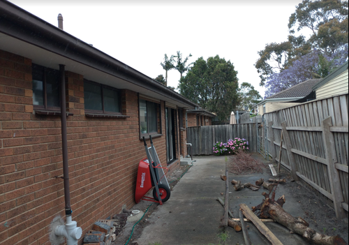

Here's a photo of where the deck will go. (The fence has already been replaced with colourbond)

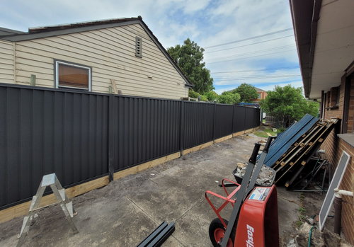

From the opposite side:

If that is a shed at one end of the deck, I think it would be the perfect place for the BBQ. I'd recommend screening off the edge of the deck with a few SpecRite 1800 x 902mm Merbau Slat Screen Panels as that would obscure the view of the shed and provide a backdrop for the BBQ. You could then place a bbq there, and perhaps you might like to leave off the left-hand wing of it. You could then screen off the lower section of the BBQ from view as you walk out the door. This would be a simple way to get a built-in bbq look without building a structure for it.
