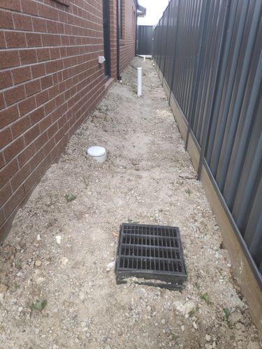

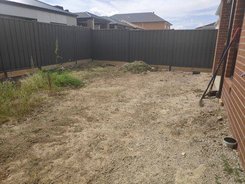

We just moved into our newly built house recently and looking forward to doing some of the remaining work on our own.
Already got the blinds fitted on our own with suggestions from this always helpful forum.
Now its the outdoors.
We have a backyard space of 12.5m x 6.7m and also the side access as shown in the attached plan and photos.
Its not level with the alfresco floors both at the backyard and side and we think we might need around 0.5 to 1 feet to get it levelled.
- What steps do we need to take to get it to level? Do we need to just add some soil or should we add crushed rocks and then top soil so that we can have a lawn and also some space for gardening around the edge of the fence ?
Looking for some suggestions and plans as we are totally confused at this point?

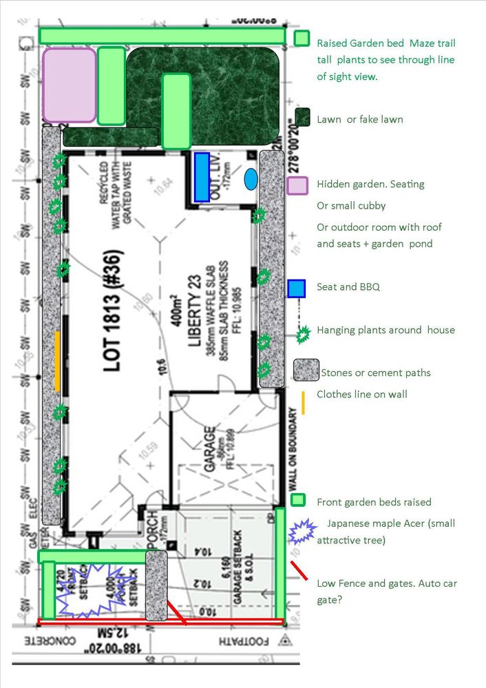

You certainly have a blank canvas to work it i know that feeling, Of coarse everything comes back to you personal live style and likes but I will add some ideas not to fancyfull and see if these ideas work for you.
Drawing has a key down the side for items you can think about.
So the main concept here is a mini maze with low plants and some 2-3 meter plants blocking the view across the yard giving the illusion of a bigger garden as you move around path different plants and different garden view untill you get to the purple zone.
Purple zone It could be your secret garden all raised beds just add soil. could be pond and seating and statue. Could be kids cubby house. could be outdoor room with roof. Gardina , or magnolias is lovly fragrent medium bushes good for blocking through view.
Use real grass or artifical lawn will save you owning a mower. Add brackets to the walls and hang plants on them to make those long alleys more cooler and people friendly. Lay black plastic and put in 5mm to 20 mm stones or concrete areas.
Hang the clothes line directly outside laundry in that lane way on the house wall . No need for sun as that alley is like a wind tunnel we have ours like that and no dramas. Use drier indoors on wet days.
You will love a smaller Japanesss maple in your yard it is house frendly no damaging roots and lovley autumn colours
Well there is some food for thought

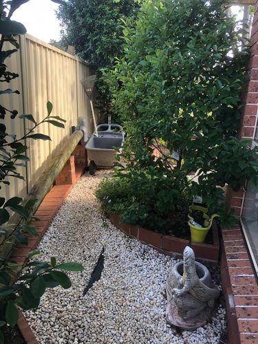

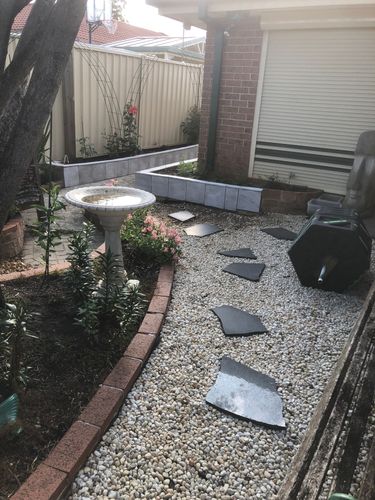

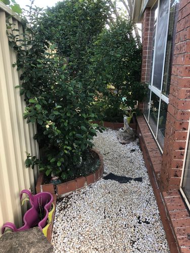

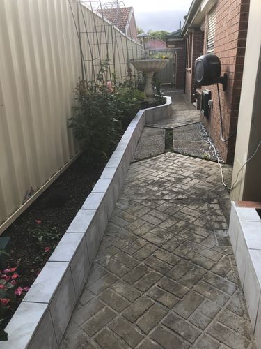

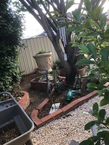

Here is a real Example
Of blocking direct line of sight it helps make a mystery of whats around the next bend and arriving in a new space. If you turn around well its a whole new place and view. A straight view and you see it in a glance.
If you have a rectangle yard with garden on outer edges you see it all in one glance and seeing it from the other side dosent really change the view.
I think the smaller the yard in todays homes this maze idea works as it can be made from flat garden panels too.
Here is a series of photos all taken while walking around a house a few meters apart every view is quite different. Now walk back the other way (not shown here) and your at a whole new place. Use objects in photos to help you navigate new photo positions,
FEATURES
- Made my garden in 3D by that i mean you look up at the tree Golden Elm and down into the lower path around the tree. Just sit on the bench on the other side of tree and the whole yard view changes yet again.
- I am using painted concrete steel trench mesh as rose arbore thingys
- loose stones crunch as you walk on them as a burglar warning. Note 5mm to 20mm stones cant easy be used as weapons or to smash house windows.

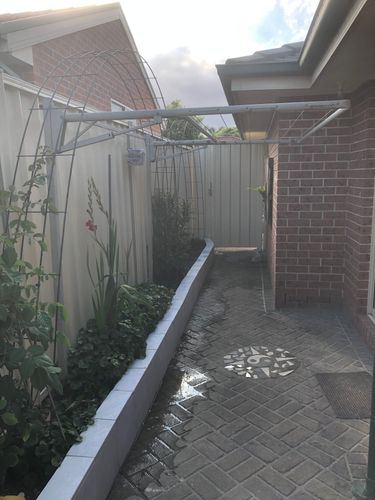

The last photo is clothes line right outside laundry so convenient 2 steps from washing machine as wind not the sun dries clothes quickly here.
- Flat path designed wide enough for wheel chair but over stones ? also my builders barrow at need.

Wow! this is so kind of you. Thanks so much for taking the time to draw up a plan with all those ideas and suggestions.
This is like a mega project for beginners like us and it's so overwhelming. We are going to divide and conquer and definitely take many of the ideas you have put forward here as small projects as we go.
We particularly liked your mini maze and secret garden idea, the Japanese maple in the front, the wall cloth line idea next to laundry, hanging plants around house.
Cheers
Sanju
Hi @sanjurajan
You guys are doing the right smart thing if you make a plan of your own incorperating your favorite ideas you can much more easily divide those projects up into bite size projects. It is also import to see how to marry one space into the next.
For a new home owner a tip :go get a few A3 photo copies (10 each inside and outside) of your builders to scale house plans to draw your ideas on then you can go to carpet people and paver people etc and they can measure of your scale drawing and give you good quotes and see 100% what you need on the spot.
The mini maze garden bed is quite easy becase you are simply building boxes on top of your rocky looking ground and you fill them with garden mix soil and it is done.
Can I change some little details lol in the secret garden to no pond but a flat wall water feature would look and sound great.
Instead of hanging pots use flush wall mounted pots would look much nicer , under the windows down the sides consider planter boxes like they have on cottages in europe so those rooms see greenery. and or flowers up at window level.
