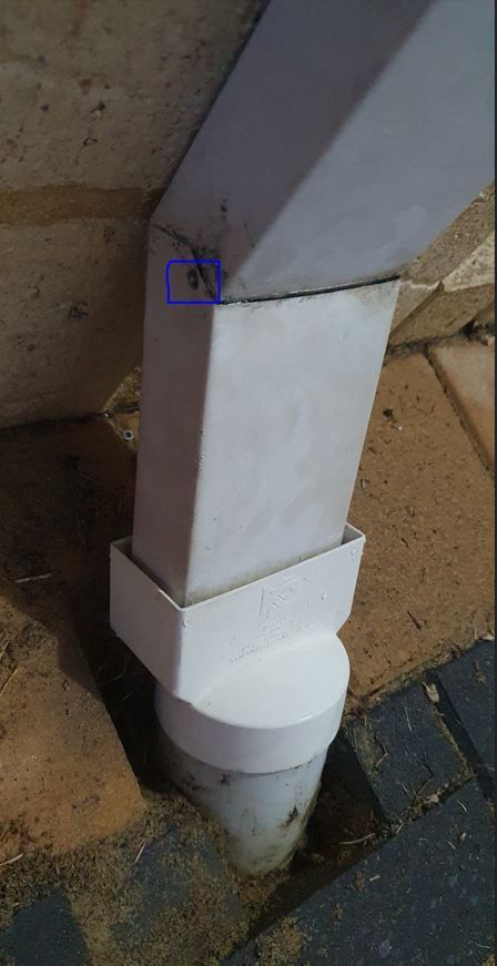

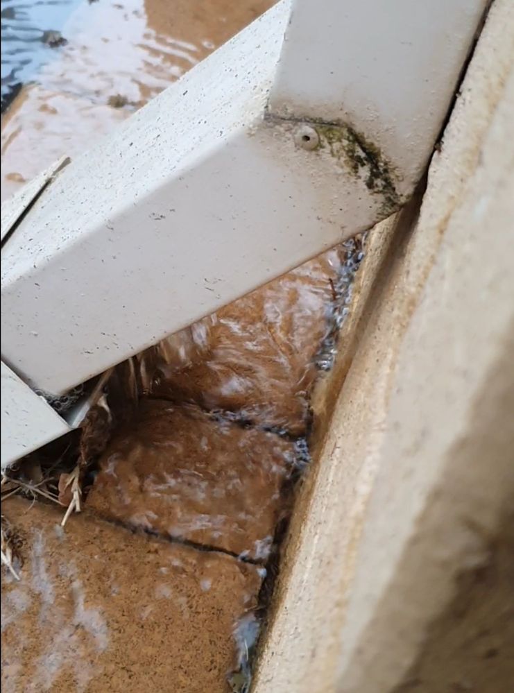

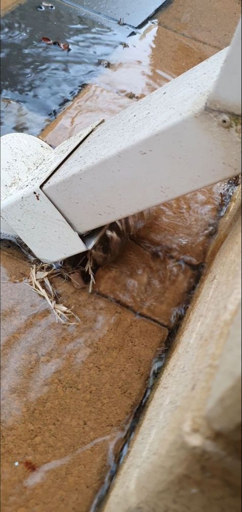

I had my roof gutters cleaned by a professional service about a month ago, and they confirmed that all the downpipes were clear. However, after today's heavy rain, I noticed that two of the downpipes are overflowing from the drain.

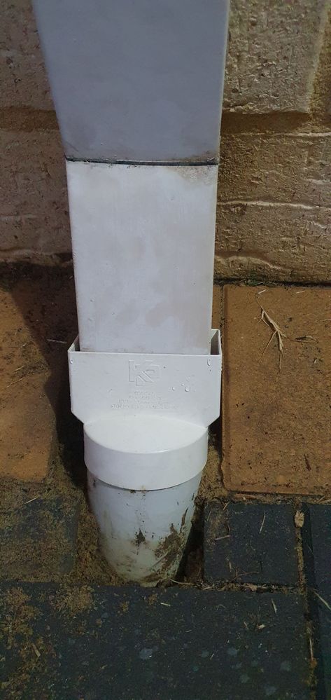

I drilled out the small rivet on the bend of the downpipe to open the stormwater downpipe adapter and check for any clogs, but I couldn't open it.
Could you please advise on what might be causing the overflow and how to open the downpipe adapter?
Thank you, Mac.
drilled small rivet to open adapter.drilled small rivet to open adapter.

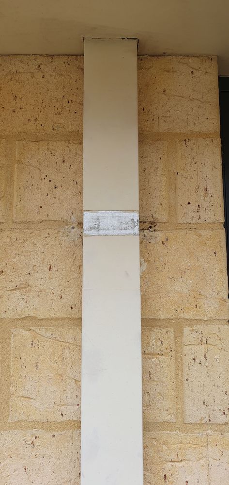

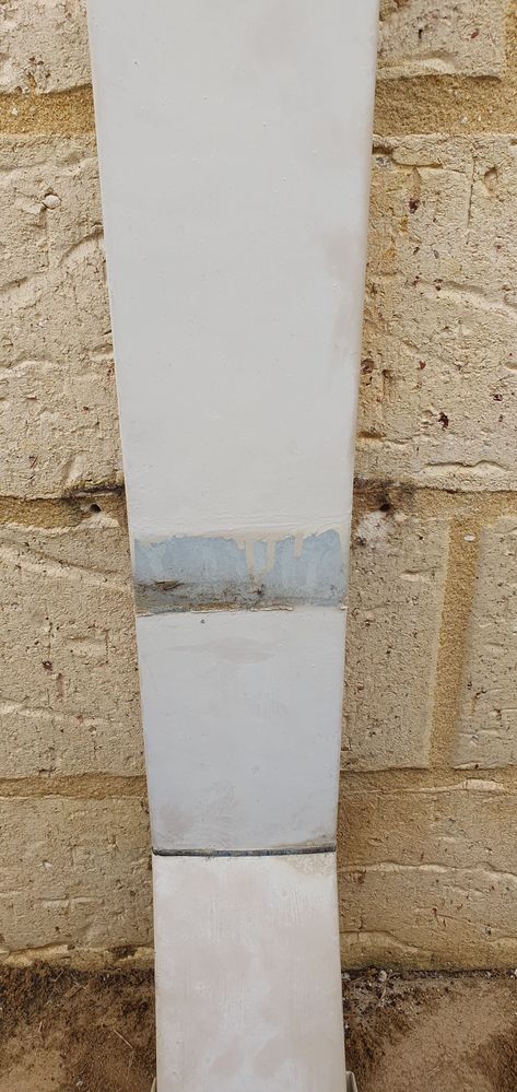

I tried your suggestion to unscrew the downpipe clamps, but I'm not sure how to open this type of screw. Could you please advise on how to do it?
As I mentioned earlier, I drilled out the rivets on the downpipe bend to open the adapter, but I couldn't get it open. Now I need to put the screws back in place, so could you please let me know which type of screw would fit?
Thank you.
Mac.
downpipe clampsdownpipe clamps

Hi @Mac4,
I'm not sure why they make the heads look how they do, but these are not actually screws, they are hammer in expansion anchors that are very similar to these Ramset 6 x 42mm EasyDrive Masonry Anchors. To remove them, as you did with the rivets, you'll have to drill them out. You can then replace them with an anchor similar to the one I've linked to above that fits in the hole.
Replacing the rivets with screws is not possible. You will have to replace them with a similarly sized rivet.
