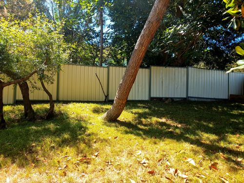

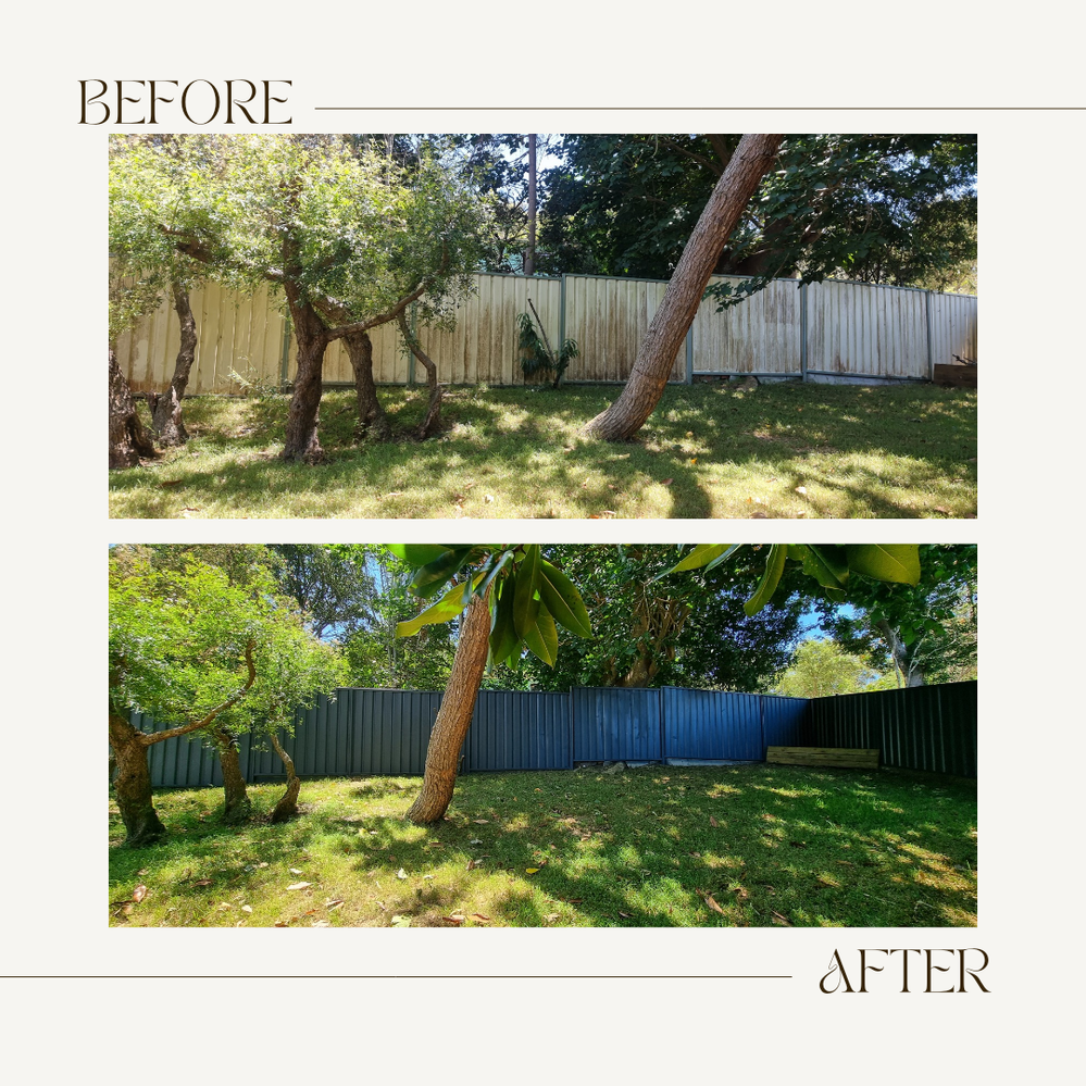

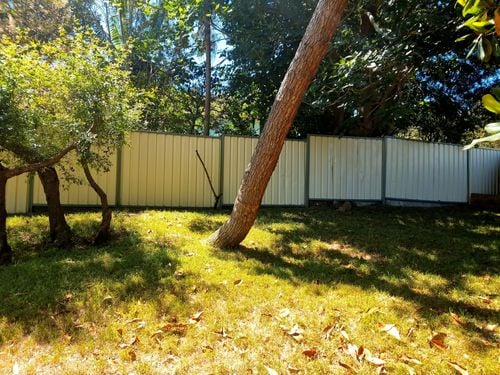

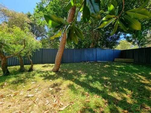

I spray painted my old colorbond fence with Taubmans sun proof in ironstone.
I had a mix match of fences, one brand new colorbond (ironstone), one an old wire farm fence, and one old cream colorbond fence.
I wanted a simple DIY project that would improve both property aesthetics and value. Painting offers an affordable way to restore the look and extend longevity without replacing a fence entirely. It was also a great opportunity to test my new spray gun as it was the back fence that was going to be sprayed, so if it had imperfections, they would not be as noticeable.

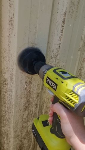

1/8The first step of the project involves preparing the surface by cleaning.
I used a brush to remove any cobwebs and dirt.
I then used some sugar soap and my Ryobi drill with a brush attachment to scrub the fence.
And finished off the cleaning process with a gurney/hose.
Note: Some people also recommend sanding the surface before painting. I did not do this, the fence is quite old, warn and has holes I wasn't repairing so didn't feel the need to go too overboard.

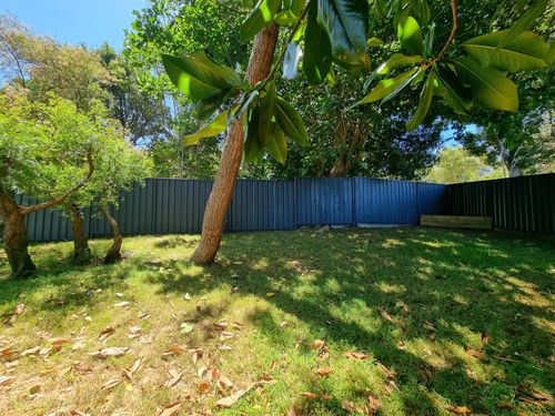

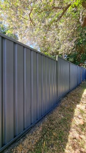

6/8Spray the fence.
I started spraying from one end of the fence on one angle in an up and down motion and work my way along, then went back and did the other angle. This helps avoid getting overspray on areas you've already painted and makes sure you get the different angles of the colorbond fence.
Tip 1: Hold the sprayer about 6-12 inches from the fence and move in smooth, consistent strokes. Avoid stopping or starting directly in front of the fence to prevent drips. Slightly overlap each pass of the sprayer to ensure full coverage. You can adjust the sprayer nozzle for a wider or narrower spray pattern depending on the surface area.
Tip 2: Apply thin coats, letting each layer dry before applying the next. (Once I got to one end of the fence I could start again.) This will prevent drips and streaks and ensure an even finish. If you see any drips or runs I fixed this with the paint brush let it dry and then gave it another coat.
Step 7
7/8Once I finished painting, I thoroughly clean my sprayer, and other items. (clean sprayer according to the manufacturer’s instructions to avoid clogging.)
After the paint is dry to the touch (but not fully cured), carefully remove the painter's tape and plastic sheeting.
Step 8
8/8Inspect the fence for any missed spots and touch them up with a brush or spray.
Re: Spray Paint Colorbond Fence.
Hi @Herrenovacation,
Well done on completing your fence transformation! It’s great to see you take on such a rewarding project. The effort you put into prepping, painting, and paying attention to the details really paid off. It’s always impressive to see how D.I.Y. projects can make such a big difference in both aesthetics and value.
Many thanks for sharing!
Good Evening @Herrenovacation
That looks brilliant! I was looking at my tired blue colourbond fence the other day and here is the perfect example of what can be!
Will be stepping through your instructions a few times i think!
Well done!
Fantastic job @Herrenovacation!
The Colourbond paint has completely transformed your fence from the raw timber. You really nailed it with the spray gun advice you got.
Thanks for sharing how you did it! Your detailed explanation is very informative and I am sure will give others the confidence to give it a go.
