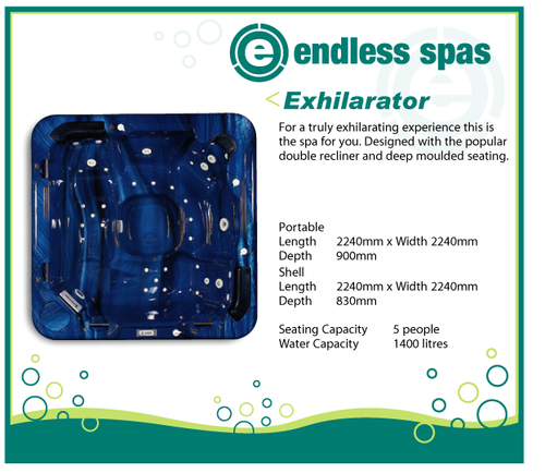

We think this is the model we have. We would have the water remaining in the tub like a pool - does that help?

Somewhere in your spa is an element filter, it is about the size of a very large can of peaches. This filter must be cleaned first before you attempt to put chemicals in the spa. Looking at the picture you posted on the lower left hand corner looks like the filter cover. The filter can be gently pulled out and given a thorough clean. Do not use excessive water force or water pressure or you risk tearing the filter. Get a clean container where you can put in some of the water you have placed in your spa. Bring this to a Bunnings store and ask them to test it. The test will reveal what you need to put in your spa water to render it safe for swimming. CAUTION : These chemicals are highly concentrated. Please follow directions on when you can use the spa after putting the chemicals in. You must give the solution time to spread out into and be absorbed in the water. Not giving it time could be dangerous and could cause chemical burns and rashes on your skin. Remember to mention that it is a SPA and not a pool so that the chemical ratio to be recommneded can be adjusted for the amount of water in the spa. One last reminder, the filter must be cleaned before using the spa every-time as it gathers all manner of dirt in the water. Enjoy the spa this summer!
