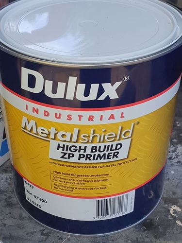

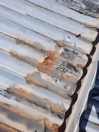

G'day Eric. @EricL
"The general procedure is to remove as much of the rust as you can and then use the Ranex rust converter."
Photos below.
I went to Inspirations Paint a few months ago and spoke with the manager about a section of my roof. Without any prompting from me he started to rant on about rust converter "being the worst thing you could possibly apply to rust on roofs."
No idea why (I didn't question him) and in the end all he offered was advice on how to clean the rust off (physically) and then to use the undercoat shown.
Any thoughts on why he would have felt that way?
