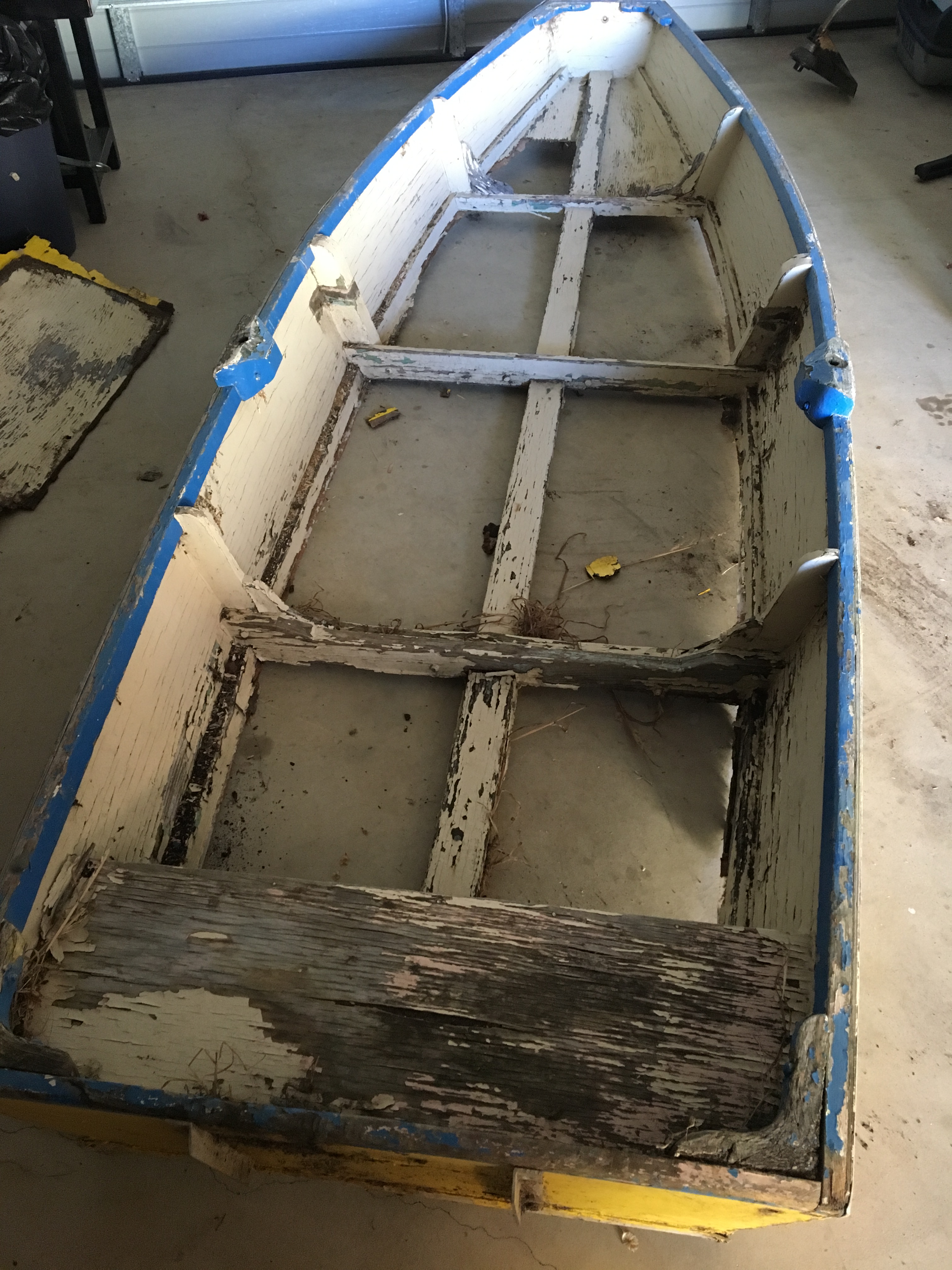

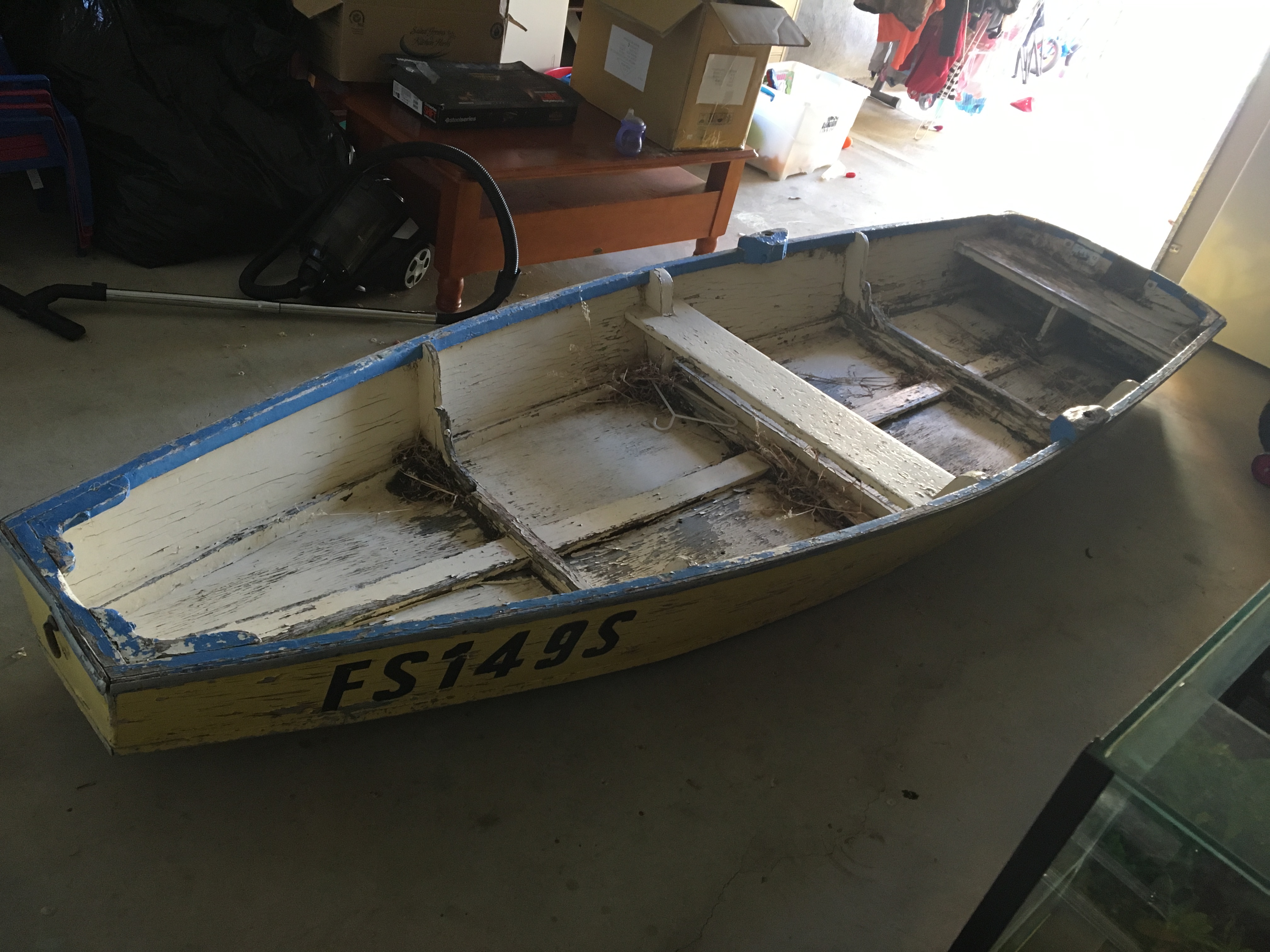

Just a quick question,
recently aquired an old wooden row boat I’m converting into a sand pit for my kids. The sides and frame are all in good condition but the ply floor board sections were pretty rotten. I’m thinking of making the new floor from cut down pallet slats screwed into the frame but I’m just curious is to how I would accurately measure the angle to contour the curve of the boat?

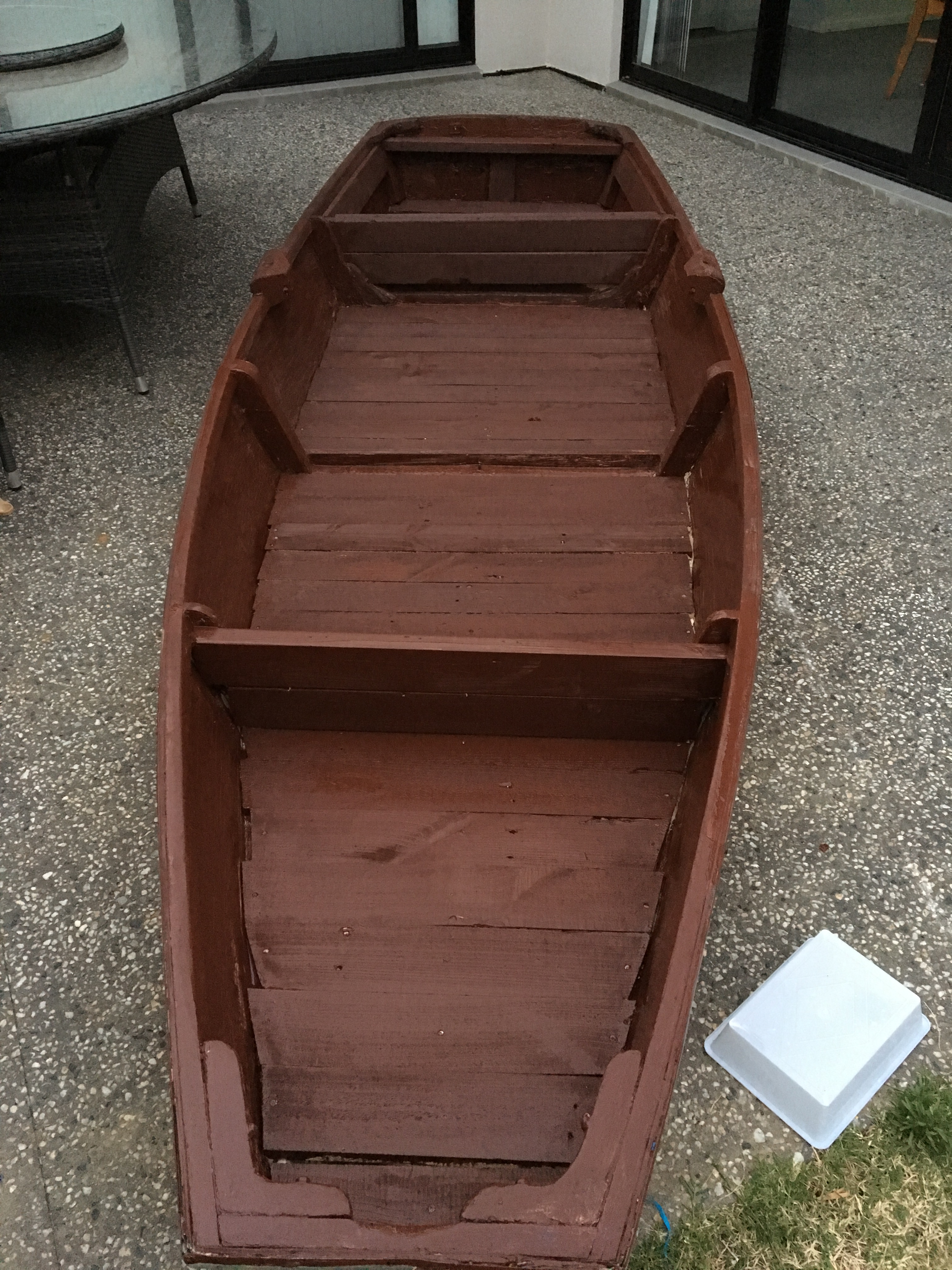

Thanks for the advice on here, sorry it’s been a while getting back.
I decided to use pallet slats as the base which I’ve painted and covered with weed matting to allow drainage. Rather than fill the whole boat with sand I’ve boxed out the middle section 6’x3’ so still a good size. I’m going to attach two 6’ treated pine round fence posts as masts next then the back section I’ll build another deck once I’ve figured out how to brace it.

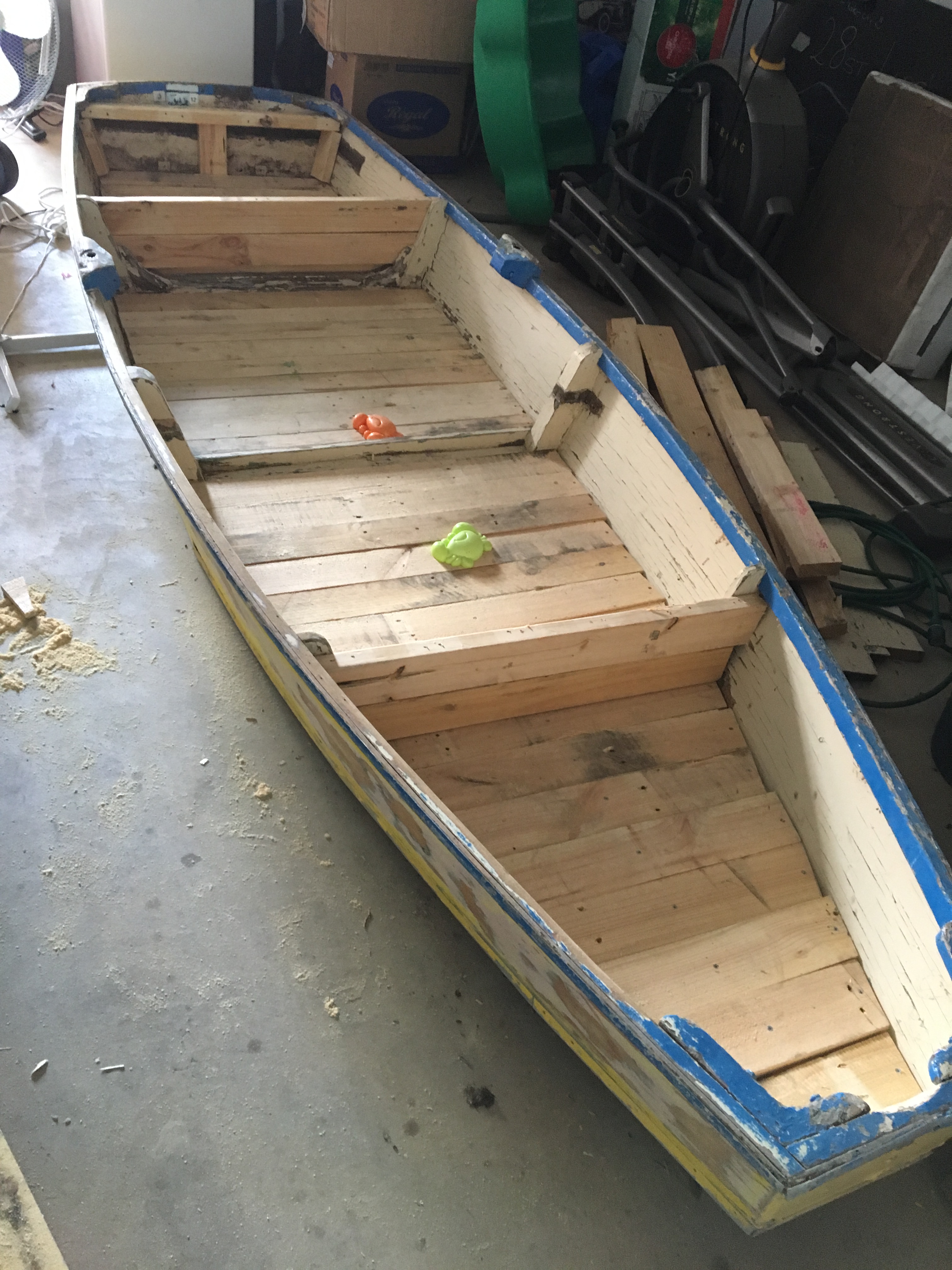

Added some pics to show progress.
There were no batteries or bits attached to the tools in the pic with my apprentices.
All that’s left is weed matting for the middle section, add masts then deck the back 😝
