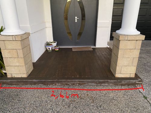

I'm in the process of planning to re-do our decking. The first part of the project is the front porch which is a 2,64 x 2.46 area.
This couples with a bigger project our back alfresco deck which is about an 82 square meter area that needs to be redone.
Basically, because of that, I'm looking at the Ecodeck 137 x22 x 5.4 long so I'd want the front porch the same as the back alfresco.

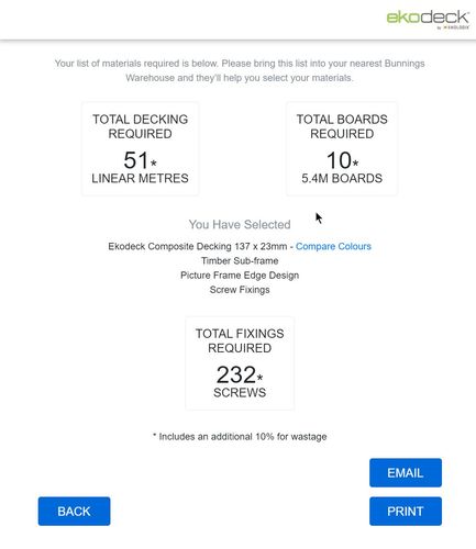

and using the link provided on the Bunnings website to calculate a deck for the front porch I come up with this: see image
Would this include the substructure materials and what I'd need for the substructure?

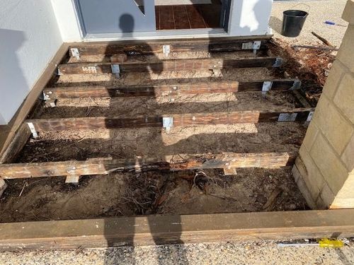

Removed the existing deck What I found the substructure was quite rotten which I will rebuild, which brings me to a question.
In order to protect the substructure is it a good idea to use something like an In-Ground Timber Protector - I'm thinking of painting that over the timber and then using Joist & bearer Protection G Tape on the top of the substructure?

Thank you so much for posting that update. You're absolutely right, some of those timber frames have seen better days. Any extra protection you can provide for the frame is always a plus. Using paint or specially designed coatings will add an extra layer of protection for the deck against the weather. Using Consolidated Alloys 50mm x 20m Bearer Protector G-Tape is another layer of protection you can definitely use.
I subscribe to over-engineering myself when building projects. It may seem overkill at the time but you can bet the finished product will last a long time. These extra protections you're thinking of putting on will provide extra years of service for your deck. We look forward to your next update.

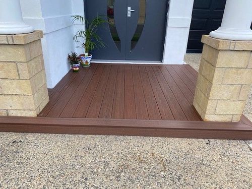

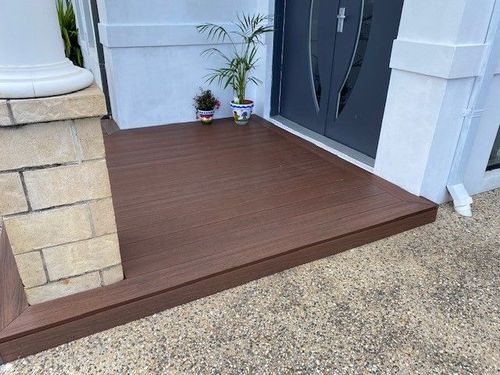

Finally got the deck complete and I am quite happy with the end result. There were a few challenges and lessons learnt along the way. Houses aren't as square as they look well at least that is what I found with this front area. I'd stay this was almost a double build, as I initially started from the wall working to the outside but didn't quite like having the ripped piece at the end so I restarted from the edge - wasn't too much of a big deal as most of the boards were already cut to size with only 2 having to be re-cut to accommodate the pillars.
Thank you, everyone, for their input and encouragement.
Darren
Re: Replacing a low-level deck
Hello @darrenh
Thank you so much for sharing your re-built deck. Looking at that photo you posted it is definitely a remodeling masterpiece. It looks professionally remade and those Ekodeck panels will last a long time. It just makes a world of difference and uplifts everything at the front entrance. What were some of the lessons you picked up from this D.I.Y. rebuild? Would you have any tips or advice for those members who are thinking about undertaking a similar project? Any information you can share would be much appreciated.
