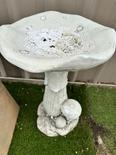

I have this bird bath and I’ve just discovered some holes in it. Apparently it’s made from fibre clay but I can’t find anywhere to buy this to repair it? Is there an alternative I can use that is bird safe and waterproof or can be waterproofed/sealed?
I don’t want to get rid of it, so if it can’t be repaired any ideas for repurposing? It’s quite shallow but maybe could be used as a planter, if there’s something I can grow that doesn’t require much soil depth?Anything that would still attract birds?

It appears that your bird bath has been out of action for a while, but it looks like it can still be repaired. I suggest washing the surface of the bird bath with detergent and water in combination with a soft bristle brush to remove the moss and mould buildup on the surface. Once the surface is totally dry and clean, I recommend using PC-11 56g White Epoxy Paste. It cures underwater and dries off-white but is tintable and can be sanded. PC-11 is marine grade when cured and therefore, is safe to come into contact with drinking water.
I recommend patching all the weak spots of the bird bath and making sure to give the putty enough time to cure before you fill it with water.
