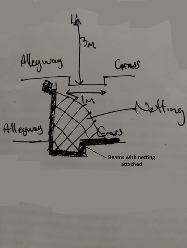

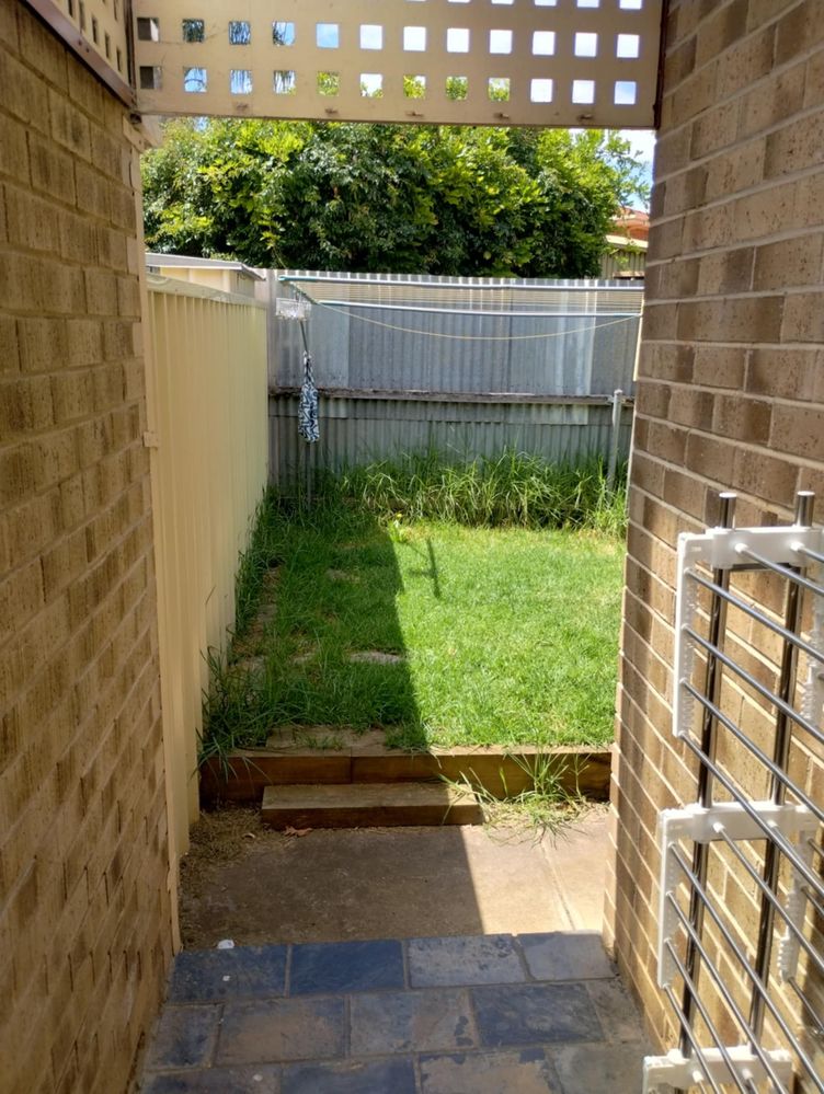

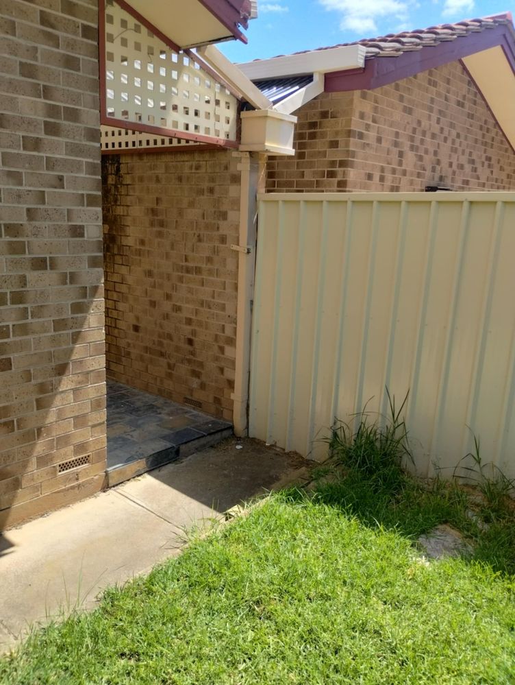

Hi guys. I'm currently renting a duplex and it has a small alleyway that runs along my unit and the other (see pictures). I would like to install a cat run that allows my cat to go down this alley and onto the concrete, potentially even out onto the grass and into the sunny area of concrete (but I am struggling to see how this is doable). Ideally this would just consist of a few beams and a bit of netting that can be sat at the end of the alley and moved easily, and obviously not something the cat can easily escape from or knock over. What I'm imagining is my simplified drawing here, potentially with hinges so it can easily be folded up. I have no idea about these sorts of things however, so I'm sure there is a simple way to do it that I am missing. Thank you for reading and appreciate any help.

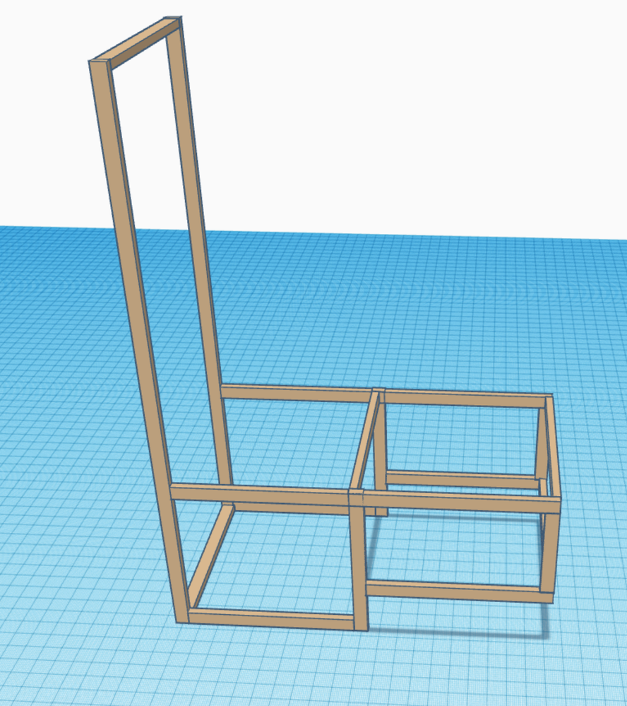

If you’re keen on making the structure foldable for convenience, you could design it with hinged panels that allow it to be easily collapsed or moved, but I would still advise having a sturdy frame that locks into place to avoid any risk of escape. You can use materials like timber or metal for the frame, depending on what’s available to you. I've created a rendering for a frame that I think will work well and be easily covered with mesh.
The beauty of a design like this is that it’s secure for your cat and can be moved if you need to. However, if you don’t need to use the alleyway often, I’d recommend leaving it in place as a permanent feature.
