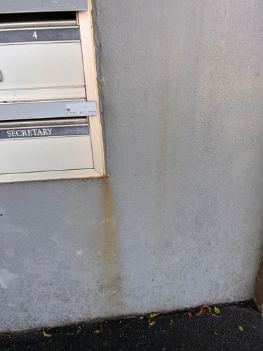

Is there a way to remove these rust streaks from a painted renders wall that was caused by name plate of building above mail boxes??

From past experience, I'd suggest that these stains are well and truly impregnated into the surface. Trying to remove them will likely be futile. Rust-removing products are typically not suitable for coloured surfaces as they themselves will leave staining. Your only real option is to use soapy water and a scrubbing brush, but as the stain would have seeped into the render, it's not something you can simply scrub away.
I'd recommend that, firstly, you resolve the issue with the rusting nameplate. This could be as easy as cleaning up the existing rust on it and sealing the metal with a clear acrylic coating. If you don't resolve the issue, then this rust staining will continue. The most efficient way to fix the wall would be to undercoat it with a stain-blocking primer such as Zinsser 1L Bulls Eye 1-2-3 Undercoat Primer Sealer Stain Blocker and then coating it with exterior paint.
