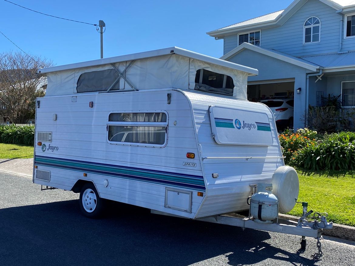

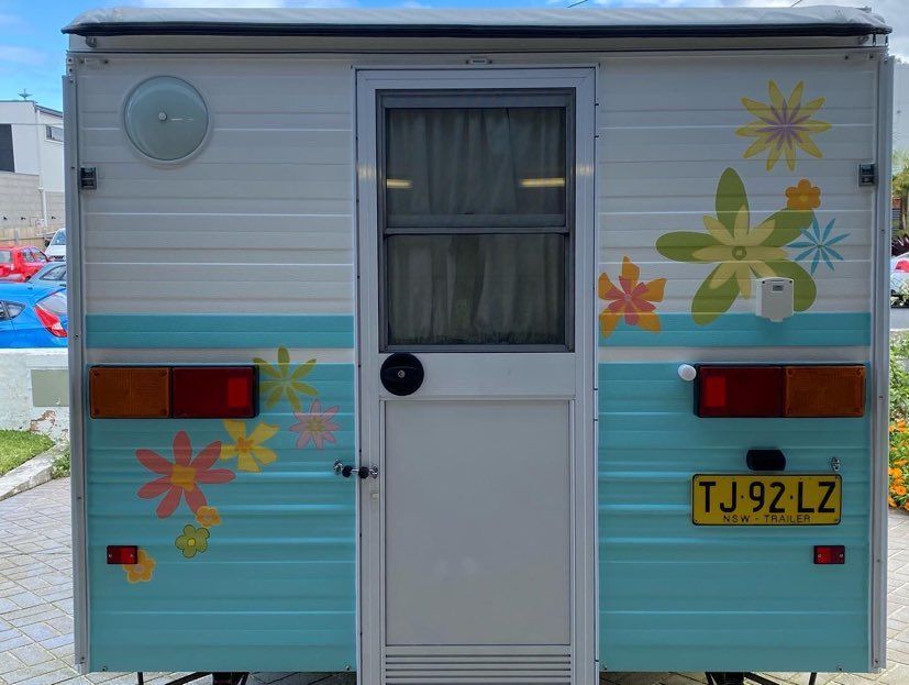

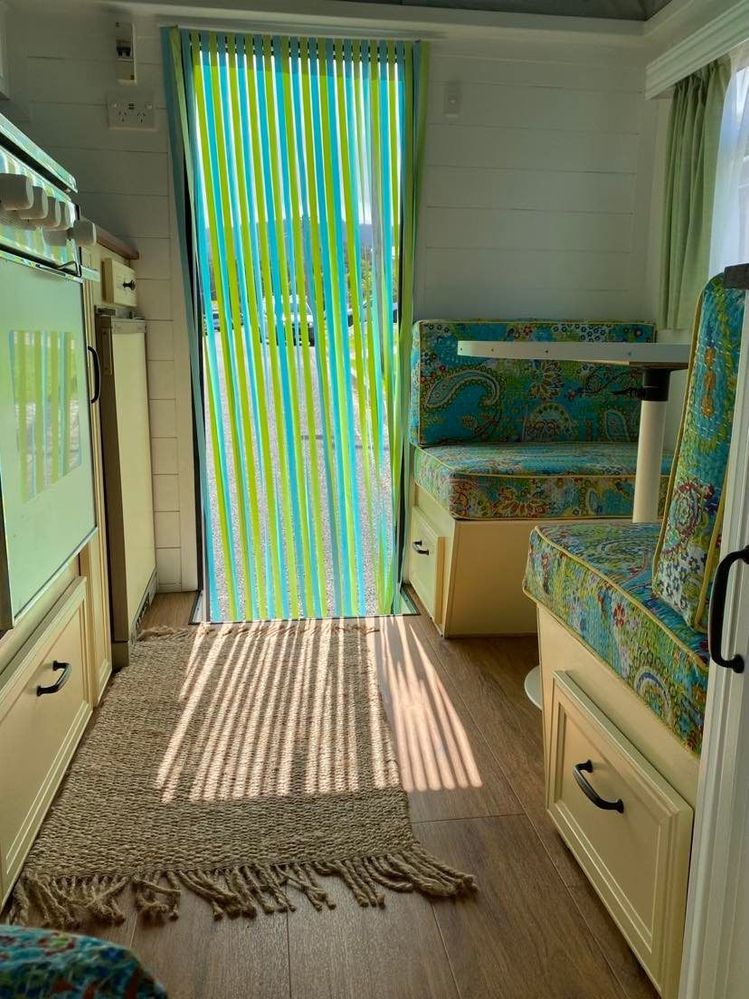

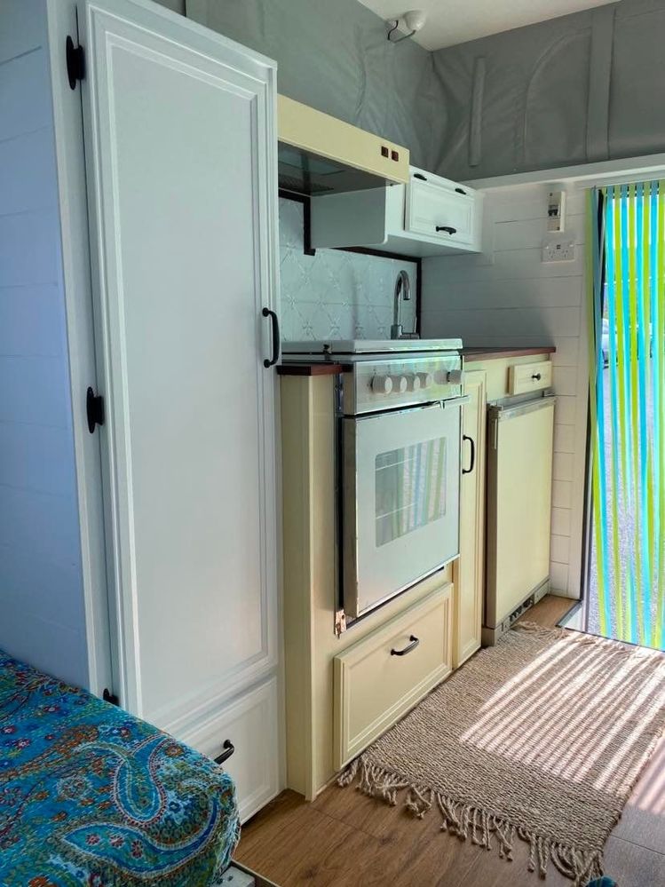

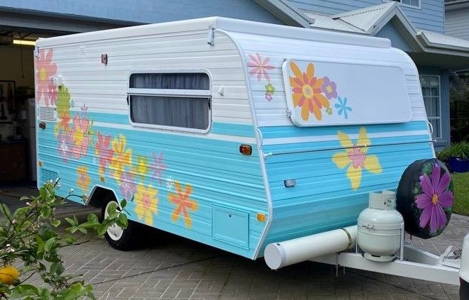

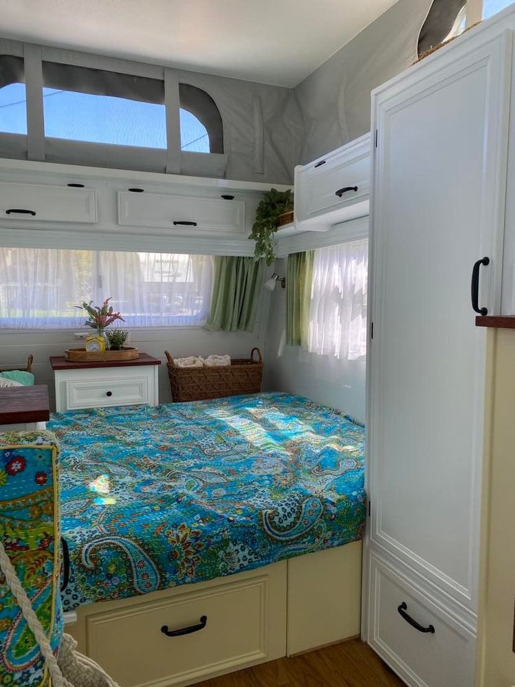

I renovated my 1994 Jayco Sprite from top to bottom, including resealing every seam on the exterior, replacing all external fastenings and attachments, priming and painting, then, with the help of a friend, adding art, to make it one unique little van. On the interior it was primed and painted throughout, new splashback, sink, tap, benchtops, upholstery, handles and knobs, vinyl plank flooring, curtains, water pumps, 12 volt system, lights, and all switches and power points. I also built a conversion frame to enable the two singles to become one double. It was like a new van.

Re: POP TOP CARAVAN RENOVATION @minnie.the.sprite.poptop
Hi @LizzieCro,
You have created such a fun and dreamy caravan renovation! You must absolutely be pleased with the transformation and I am sure it will be admired by many of our caravan enthusiasts like @twocutekelpies, @selva, and @woodenwookie. Great projects like yours may make it into one of our Top Ideas articles like our 10 caravan renovations one day.
Did you paint your flowers with a stencil or by freehand? Do you have any tips for someone who is looking to take on a caravan reno of their own?
Katie
Hi Katie,
Thanks very much.
The flowers were painted freehand, by myself and a friend; my design, his flower shapes, a real collaboration.
Tips to take on a caravan renovation..... research. Join forum groups for caravan renovations, and use the search icon to find the information you need. Ask questions, record info, LEARN before you buy the van. I've been looking at caravan forums for 4 years now, and I'm still learning things. If you think renovating a caravan will be easy, you may be disappointed. Unexpected things occur, they're rarely as quick to renovate (properly) as you think they'll be, and the van reno's rarely come within budget. I've seen so many people give up half way because they realise the cost of finishing the job is far too much. Remember the critical issue of weight in the caravan, and use lightweight materials only. If your van is finished and beautiful, but exceeds the permissable weight, you won't be able to register it, and, in the event of an accident, your insurance company will not cover you. Do your homework. Having said all that, it's a very rewarding renovation to do, and will skill you up for many other things.
