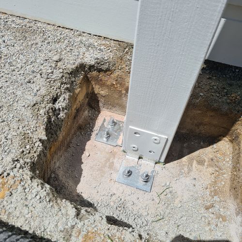

Setting the posts.
The two posts on the rear boundary were Dynabolted to limestone retaining wall and concreted in, while the other two posts were concreted 600mm into the ground.

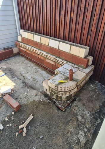

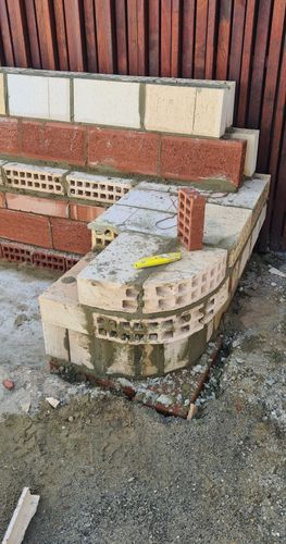

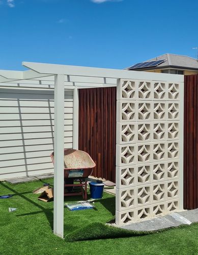

Breeze block wall

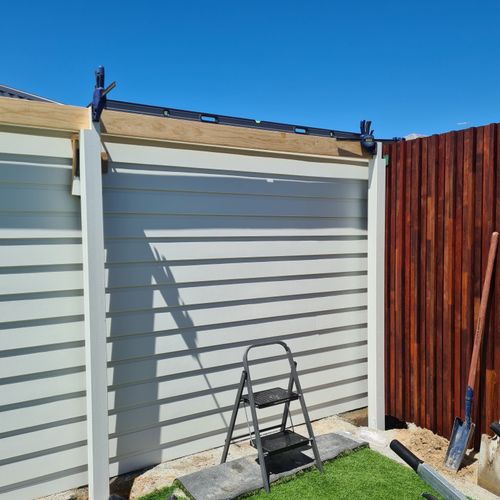

I clamped the roof from to the post to give the finishing height of the breeze blocks so I could work back from that to set the footing to ensure we used full blocks right through. There's a 10mm rod through each row of mortar which is set into the timber post for plenty of strength. These particular breeze blocks are made with 20mm channels on 2 perpendicular sides to make the rod easy to embed.

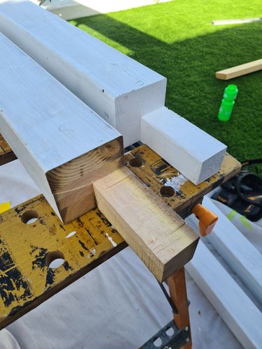

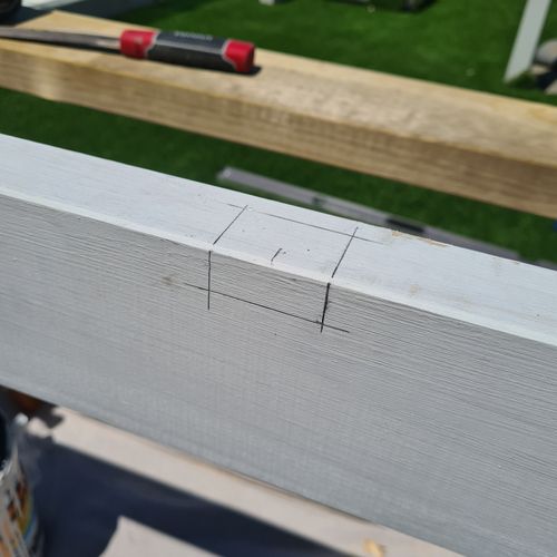

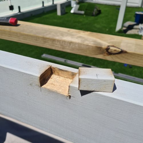

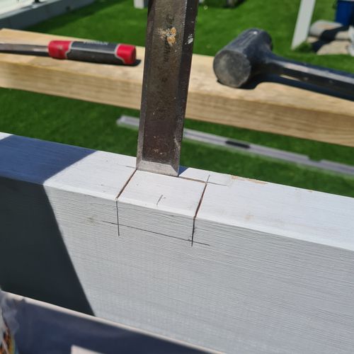

With the breeze blocks in I finished the rest of the timber frame all fixed with bugle batten screws. I notched out parts of the frame to flush fit the cross members which are there both for supporting the bamboo roof as well as adding feature. This was made easier with a multitool to make the initial cut (after a few taps with the chisel to give the multitool a line/crevice to start in and follow), then fine finished with the chisel.

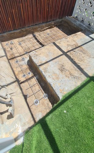

Curved concrete bench seat and crazy pavers

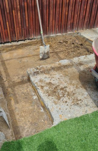

I dug the footing, installed a bit of reo, and poured the concrete ready to start building the bench seat.
I was going to build the concrete bench seat myself as I have the skills to do so, but after seeing a design by a local professional I decided to enlist his help (and when you see the finished product, you'll understand why). And given he did such an awesome job on the benchseat I got him to quote the crazy pavers too. Again, I could've done the crazy pavers myself but his price was so good that weighing it up against the time/effort it would take me to do it, it just wasn't worth it.

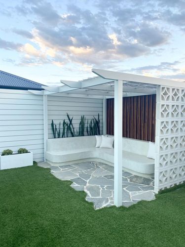

The finished product
With all that work done, it came down to the finishing touches such as sealing the bench seat and crazy pavers, cutting the fake grass to fit around the natural edges of the pavers (which I did ask to bring out further but something was lost in translation), and popping some greenery in there.

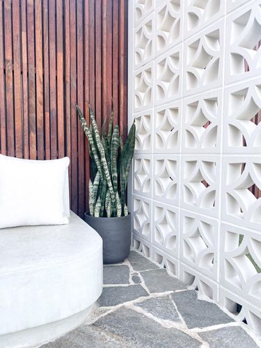

That bench seat! Curves in all the right places, tapered back rest, polished concrete effect finish.
Super stoked with how it all turned out and got in done just in time for our annual preXmasXmas party and all the festivities that've followed throughout this beautiful Perth summer.
