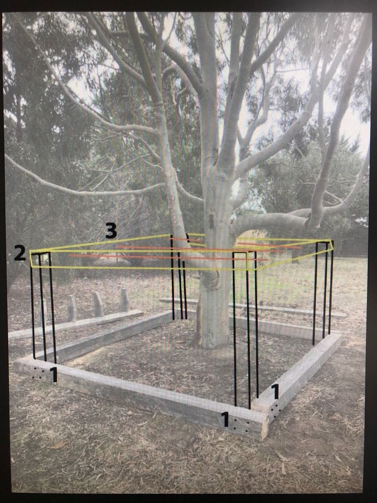

1/5- Quick sketch design and check in with Bunnings Workshop community to seek advice!

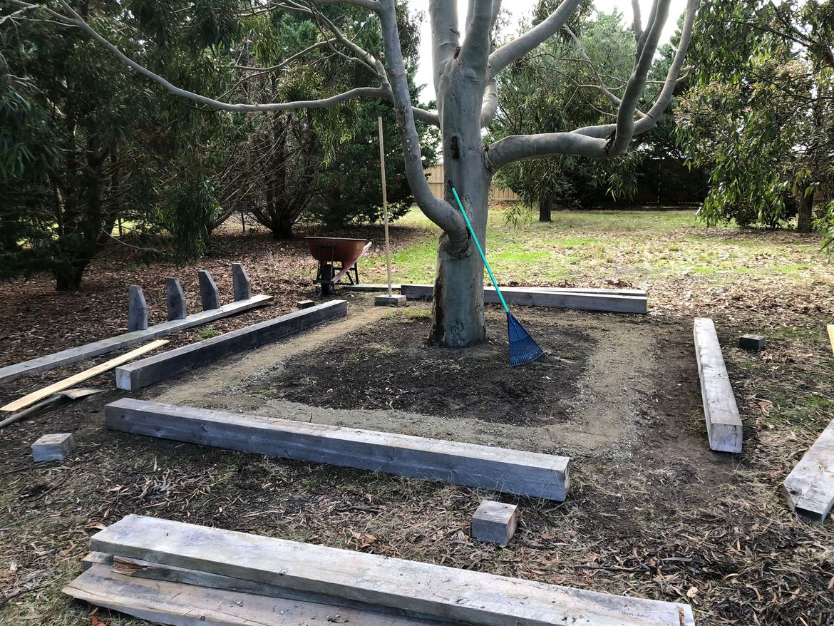

- Clear and level ground around tree for base
- Lay and compact 20mm gravel for base of frame to sit on (to help provide a sturdy base and improve drainage)
- Paint all wood in contact with ground with Bondall wood protector
- Cut and fix timber with large screws

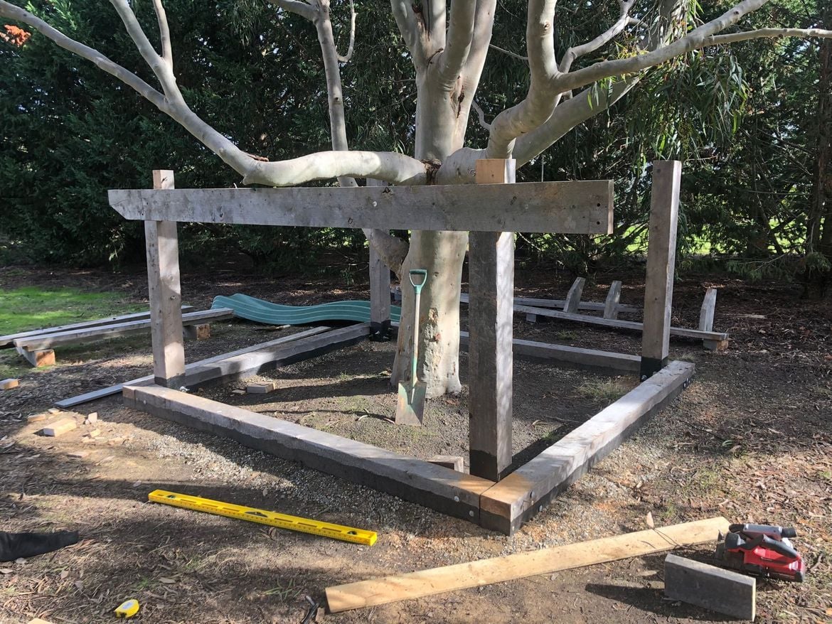

Step 2

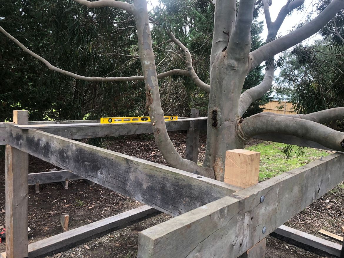

2/5- Cut and attach frame legs using M12 through bolts

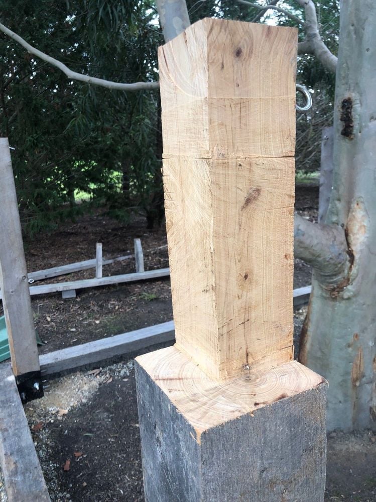

- Cut notches in top of posts for frame sides, ensuring all plumb and level
- Install frame sides using M12 through bolts

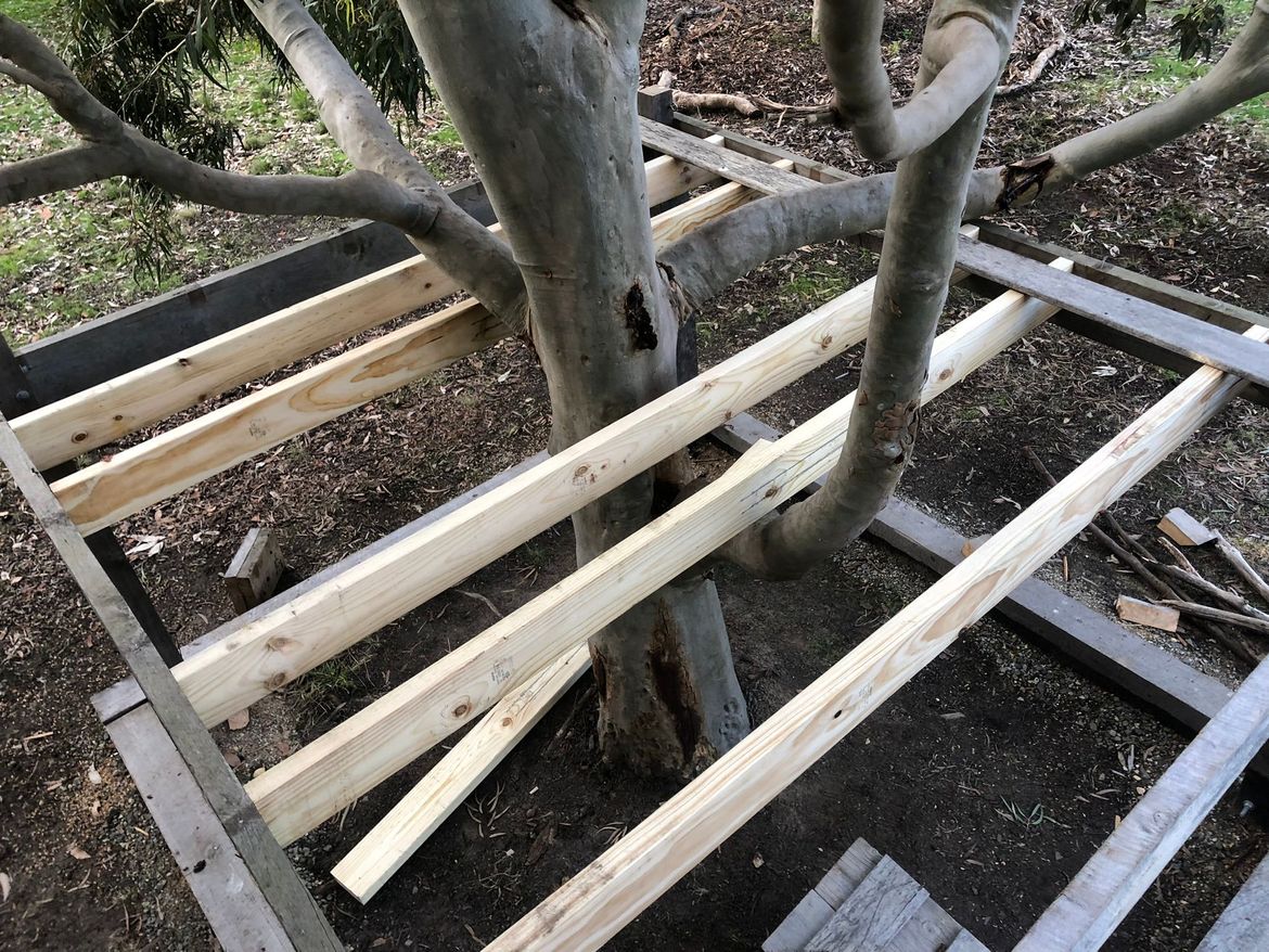

- Install joists made from treated pine - size and spacing of joists based on expected deck weight and length of joist span

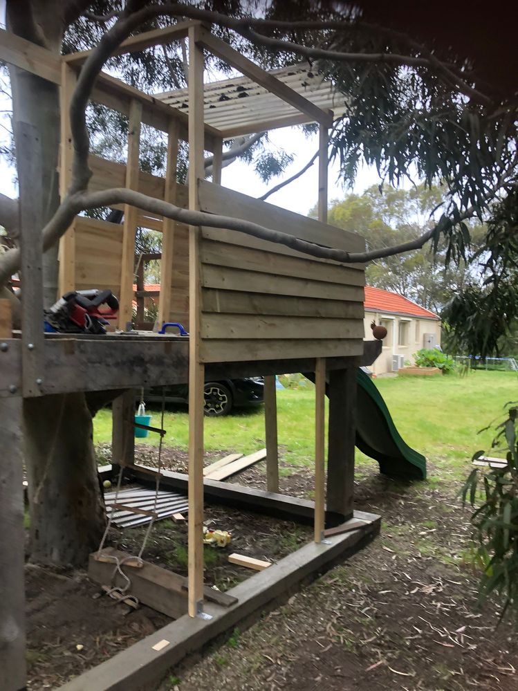

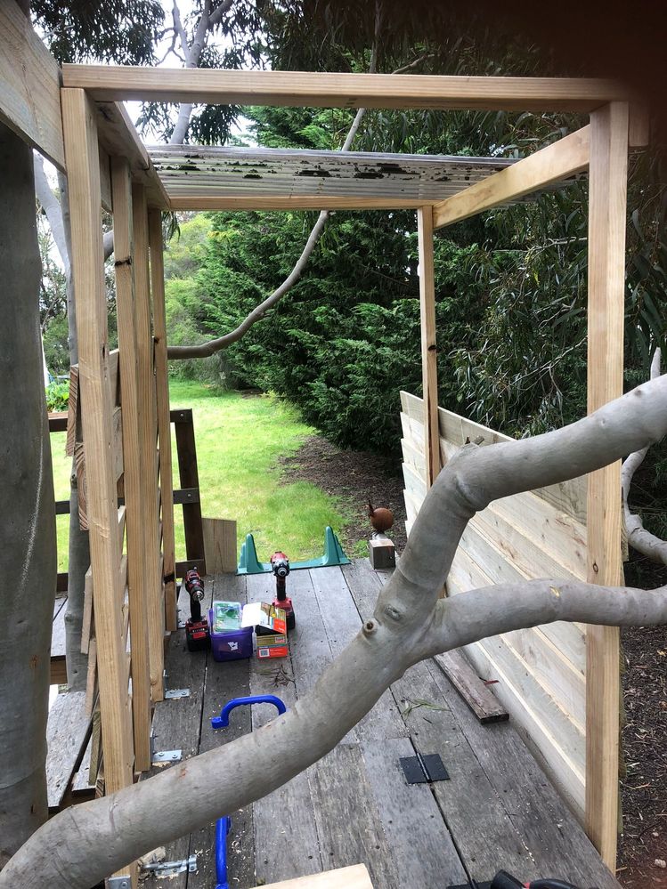

Step 4
4/5- Install spotted gum decking on top of floor joists

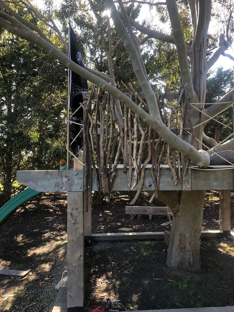

- Install balustrade frame using cut lengths of spotted gum decking before installing branches collected from site as railings

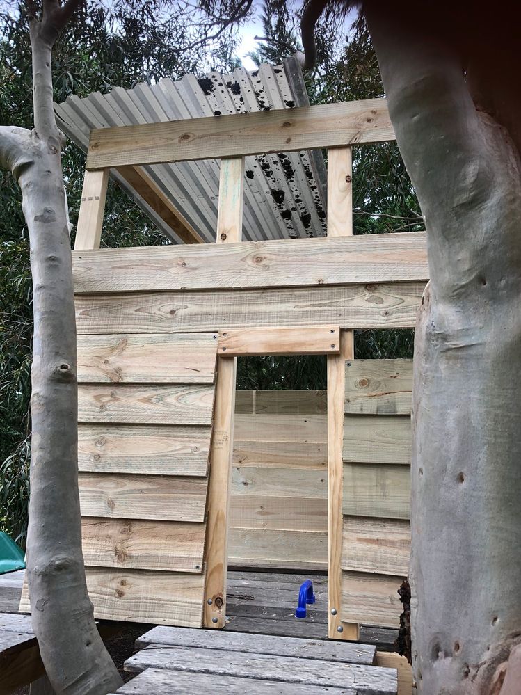

- Treated pine used to create cubby frame with fence palings used for cladding - all fixed with treated pine screws

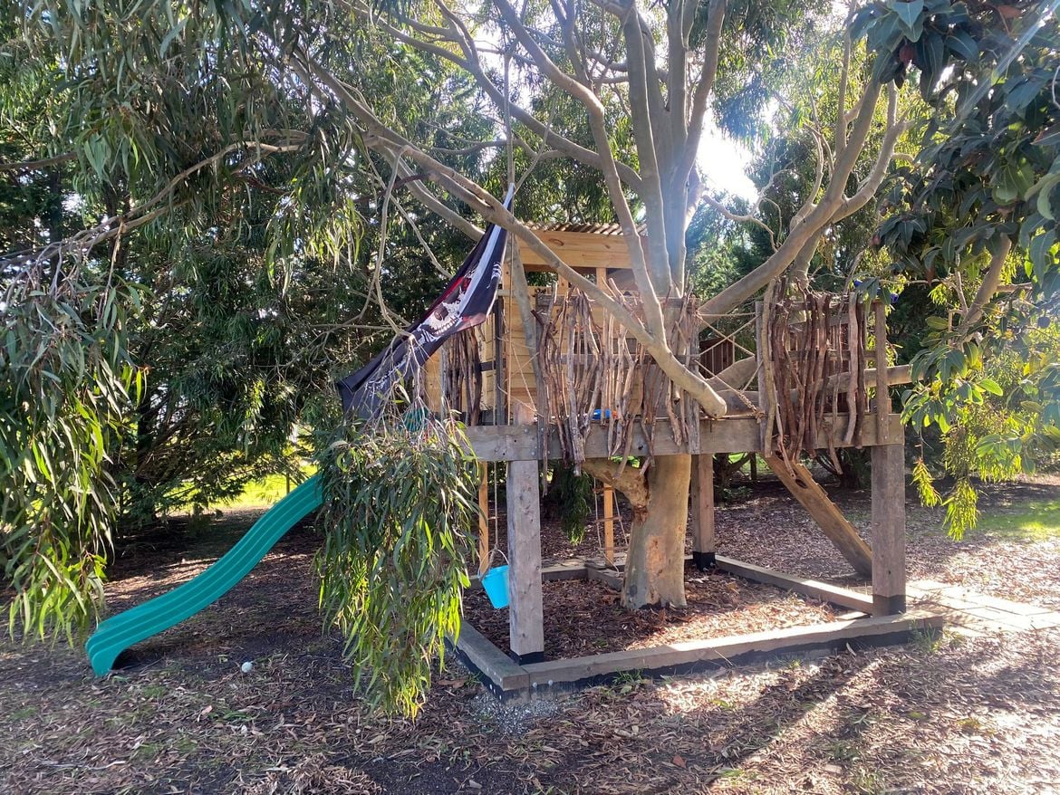

Step 5

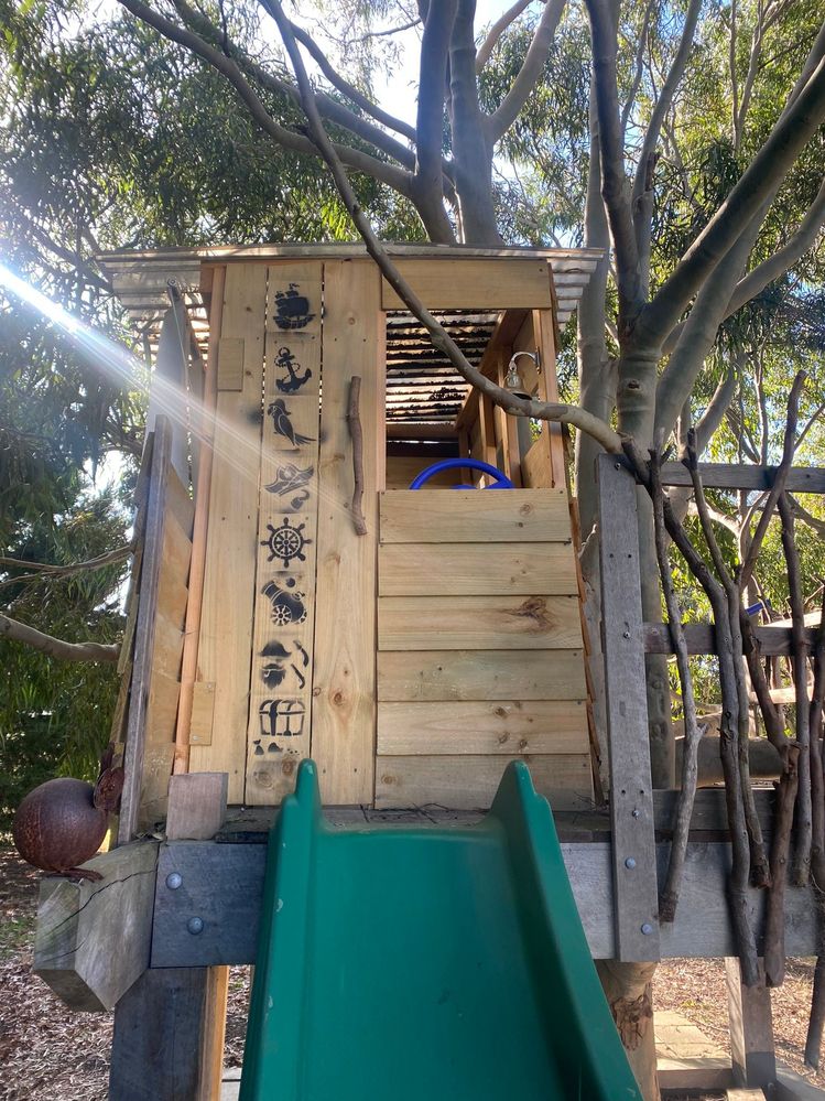

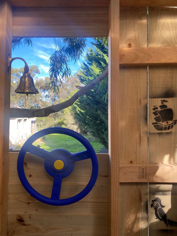

5/5- Final fit out including wooden ladder with climbing holds
- Rope ladder
- Trap door made from wood scraps and gas lift struts

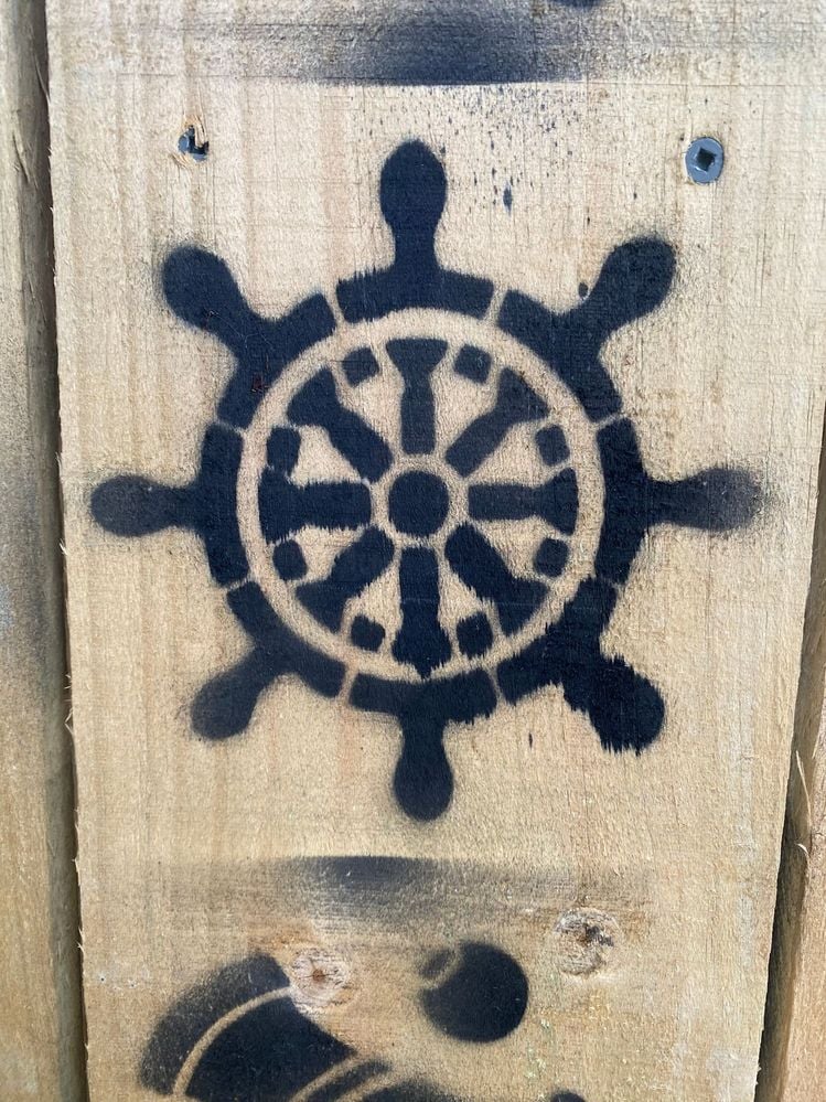

- Install periscope, wheel and bell
- Add pirate swag (flag, spray paint decals)
- Encourage kids to stop watching TV and get outside!
