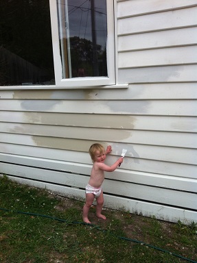

I've started to wash it down with sugar soap and it's actually coming up amazing well considering its age.

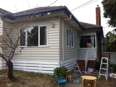

The painting is coming along, but it's not quite finished yet.
I need to do the windows, boards and guttering so there is a bit to go.
I'm a bit stuck on the colour matching for the guttering & base boards but I have my very own mini exterior designer helping to pick the right colours!
