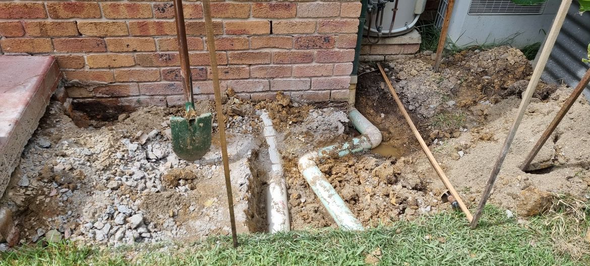

I have an area mapped out of about 1800mm long by 1000mm wide designated for the shower.
I have dug down a little and discovered a 90mm storm water pipe and a 100mm sewage pipe.
Being a shower it will be connected to sewer.
I have two plans and my sense is that decision will be dictated by the ability to drain the shower (and a sink).
Plan 1.
Pour a slab (to be tiled later) with a grate drain in one end of it, draining to the sewer.
Plan 2.
Raise timber frame and insert a tile able shower base.
The challenge I have is that from the top of the sewer pipe to the top of the slab I only have 260mm clearance.
Having to fit a trap and into that height seem tricky to impossible.
While with a raised timber floor I gain another 300mm clearance making the whole clearance 560mm.
I am uploading a picture of the site here (sewer pipe is on the left).
Your thoughts will be appreciated.
Re: Outdoors Shower draining plan
Hi @Alon,
Thank you for providing additional details and the photo—it’s very helpful for assessing your options. Given the limited clearance of 260mm from the top of the sewer pipe to the slab, you will likely need to install a compact trap to make it work. Compact traps are specifically designed for situations where space is tight, and they can help you achieve proper drainage while staying within the constraints of your setup.
If you opt for Plan 1 with the slab and grate drain, the compact trap could be positioned to maximise the available height. However, Plan 2, with a raised timber frame, does offer significantly more clearance, which would make the installation much easier and provide greater flexibility for future maintenance or adjustments.
