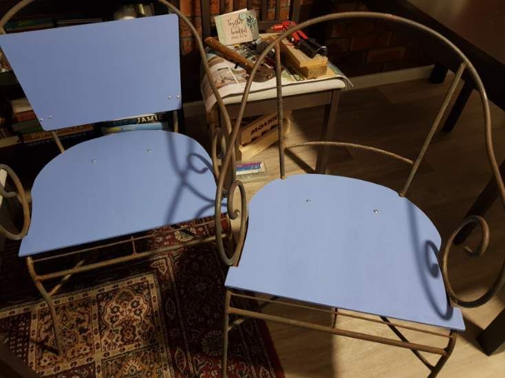

5/7After the paint is dried .we placed the back rest on to the chair and marked the location of the clips and holes for the rivets.
We used saddle clips to hold the back piece on .
Step 6
6/7We used pop rivets through the front of chairs so it looked nice .
Step 7
7/7We fixed the seat of the chairs using some screws we found in the shed to suit the holes already there.

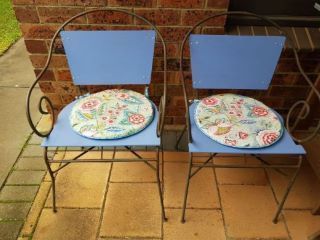

A picture of the completed chairs
Completed chairs

Thank you for sharing your fantastic outdoor chair restoration project. I'm a big fan of giving used furniture a second life. The saddle clips you used to attach the panels to the steel frame was a great idea. The blue colour you've chosen is very relaxing. An overall excellent effort in upcycling.
