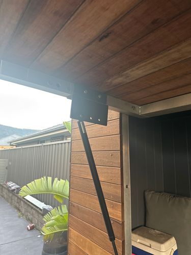

Love the project. I have been looking to do similar and think maybe this year but the thing I'm least sure about is how to hinge the door. Can you advise how you approached this and/or what you used?

Given the weight of the door, I suspect several heavy-duty hinges were used. You've then got the gas struts that help raise and hold the door in position. The struts we keep in-store are of the lighter variety, so you might need to speak with our helpful team at your local Bunnings Special Orders desk to order some more industrial-sized versions from our supplier, Goliath.

I made a lot of mistakes when I was doing it. I design it so the do reopen on it self when it is shut that how it stay shut. Both of the struts hold about 300kg each. The door is made out of aluminium and so is the frame that the door is in. The rest of the bbq area is made out of timber. the hinge i used m12 hi tensile bolts
for me it was all try and error. I wish I could be more helpfully
