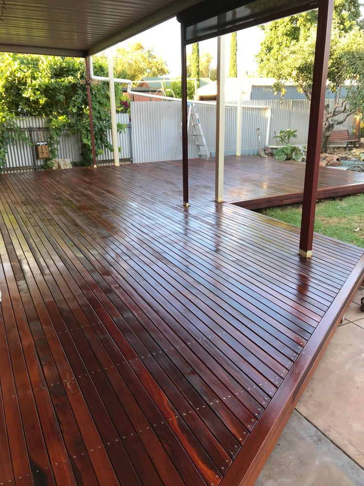

Hi All,
Wanted to share with you our new deck. It's been so nice to be able to enjoy it over summer!
It was built over some old concrete and natural ground. Approx. 60sqm in size.
- Treated pine for bearers and joints
- Belian (Malaysian Hardwood) decking
- Finished with an oil.
Happy to answer any other questions you might have.

Very impressive work @DIYgals! Thanks for sharing all the progress photos. It's always so inspiring to see a deck take shape. How did you settle on the type of wood to use?
Jane
Re: New Deck
Thanks so much @JaneK . Wanting a hardwood and affordability weighed into our decision making. We were lucky enough to come across a supplier in Adelaide for the Belian. We really loved the colour and when we did a bit of research on the timber we found that its durability in and above ground is excellent, and it is resistant to termites! We did have to purchase a whole sling so we should have plenty to go around the new studio which is currently under construction atm.

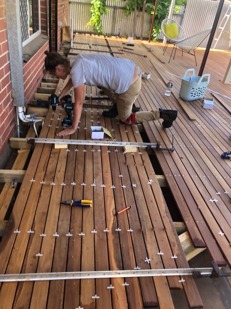

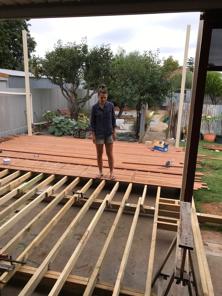

Re: New Deck
Thanks @MitchellMc we are very happy with the end result. The picture framing was quite difficult to get our head around, lots of little extra bits in the framework to think about. But we got there in the end!
