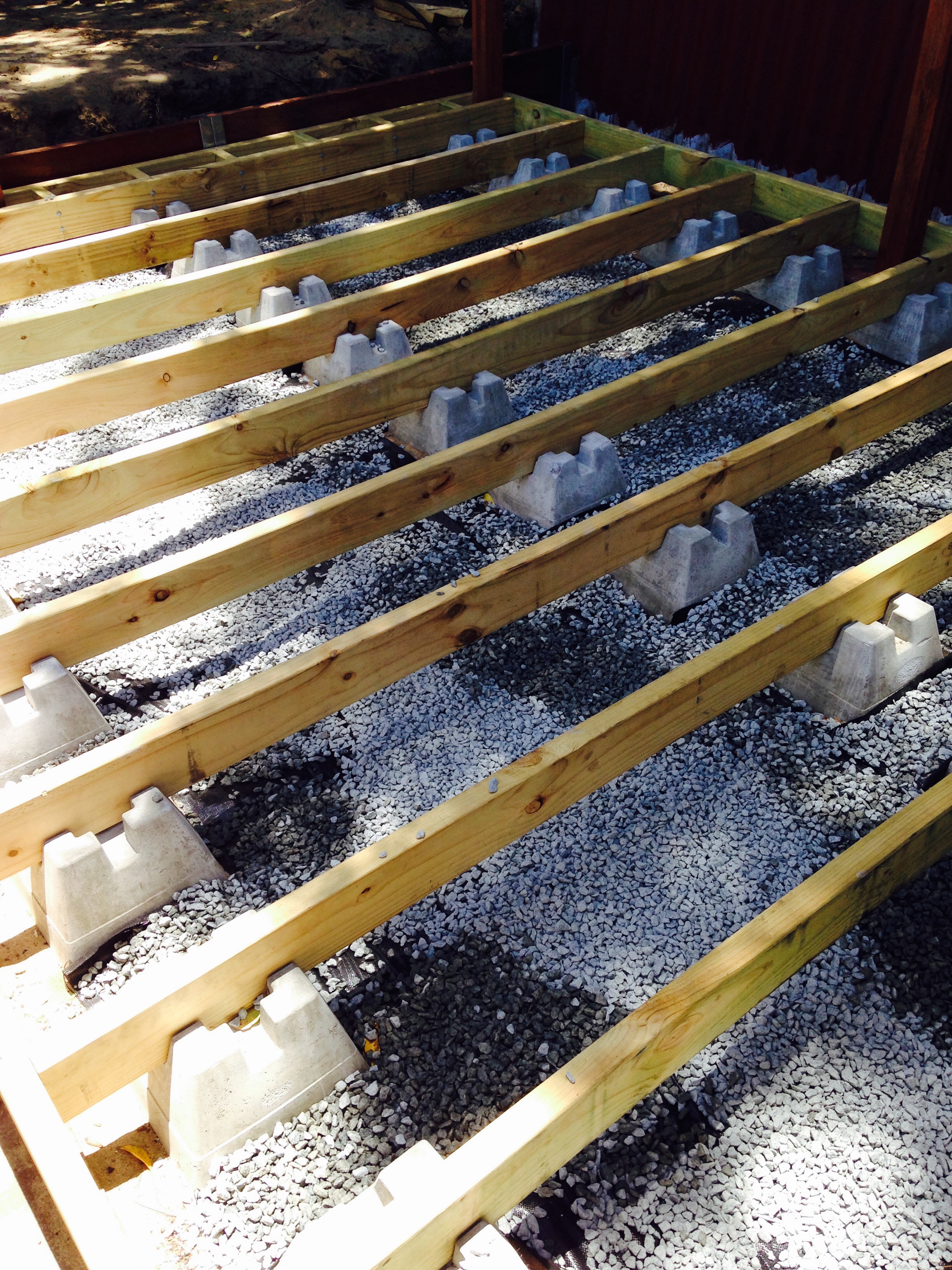

@Daniel as our backyard is technically common land ,due to the strata title, I didn't want to make our deck overly permanent so I used Evo-Crete Handi Blocks. There were mixed reviews about them but once down it is solid as a rock and I found it pretty easy to get them aligned and level. As you don't have joists and bearers it sits pretty low to the ground.
