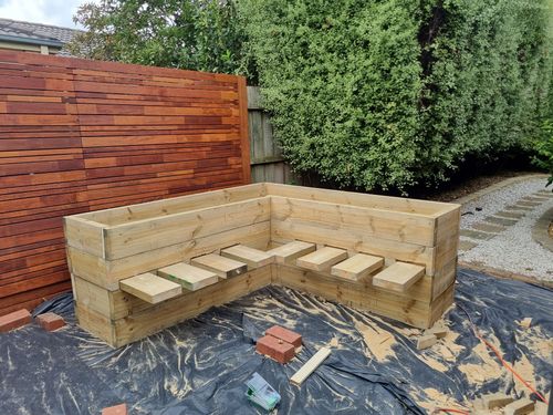

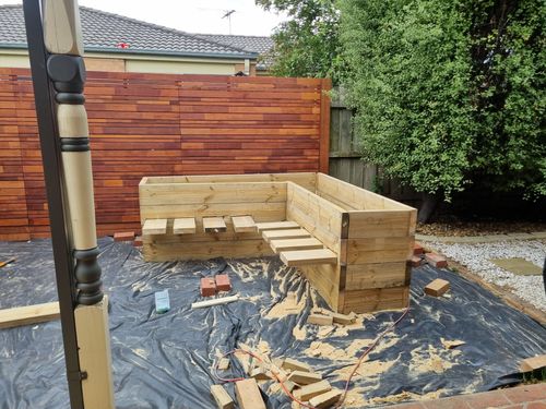

Re: Ideas For Small Outdoor Living Area
Current status on progress, next step is the cement sheet cladding and then rendering

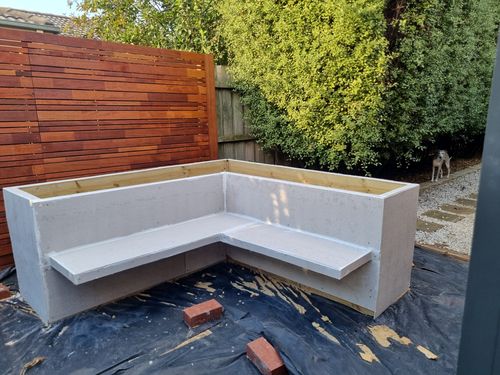

A couple of questions:
1) I'm hoping I don't need to use metal angles for the corners of the cement sheeting? I've got some https://www.bunnings.com.au/builders-edge-50mm-x-20m-fibreglass-builders-joint-tape_p0730318 that I was planning to just use for the corners / joints in the cement sheeting giving it's just an outdoor furniture unit and will be rendered anyway. Can I just tape and then what kind of product should I spread / coat over the tape with? Something like https://www.bunnings.com.au/gyprock-csr-2-25kg-less-mess-multi-purpose-joint-compound_p0173344?
2) Instead of the Dunlop render used in the original project, could I 'paint' over the cement sheet with this product to give a rendered effect? https://www.bunnings.com.au/dulux-4l-medium-texture-exterior-paint-4l_p1409809 I see there is also an associated primer, does this need to be applied first or can I get away with using the texture paint straight on the cement sheet?

Afternoon @Calvin91
Woooo you are powering along! It looks great. (would love to see an inside shot as to how you have attached those seat slabs)
As to the question with the cement sheeting, What size sheet are you thinking of using? I would be tempted to have the corner edges sit flush as you can and then use a jointing compound over it. Then paint with that "fake render" perhaps you have mentioned? I would wait for one of the other guys to confirm as they do know more product wise
I dont think I would use the tape (lifespan is the only reason why) but I havnt used it before either for that matter.
Hi @Calvin91,
Nice work so far, it's coming together nicely.
Unfortunately, mesh tape is not suitable for use on external corners, nor is plaster compound suitable for use outdoors.
You could use the mesh tape on the internal corners, but it would not be suitable on the external corners. As there is no real volume to mesh tape, the render itself would form the protruding edge. If you use a bead, the metal or plastic of the render bead forms that protruding edge, so if it is hit, the bead is hit, not the render, which dramatically decreases the chance of the render cracking and coming off.
If you use beads and render, there is no need to coat anything before rendering.
If you decided to use the Dulux Medium Texture Exterior Paint, I would just but the sheets into each other, seal the seam with No More Gaps Exterior Gap Filler and then paint over the top.
If you use this paint, you will have to use the Dulux 10L Texture Paint Primer beforehand.
Hi @Dave-1 thank you
I'm just using some 4.5mm thick James Hardie cement sheets - https://www.bunnings.com.au/james-hardie-2400-x-1200-x-4-5mm-2-88m-hardieflex-cladding_p0711396
What kind of jointing compound would be suitable? Would the one I linked above be ok?
Sure no worries - also keen to hear feedback of others too thanks again for your help and input
Hi @JacobZ thanks for your assistance! That makes sense, I reckon I'll just go with trying to butt the sheets as close as possible, seal with the no more gaps and then prime / paint with the dulux products - sounds like it'll be a bit easier than having to use the render beads on the corners and I assume the texture paint is a bit more forgiving than normal render in that it won't come off if it's knocked etc.
Hi @Calvin91,
Just to jump in on your questions for @Dave-1.
Unfortunately, the multi-purpose jointing compound you linked to above cannot be used in an outdoor application that would be regularly exposed to weather.
You can use Dunlop 3kg Fibre Cement Jointing Compound as long as there is a coating, such as render or textured paint applied over the top.
Let me know if you have further questions.

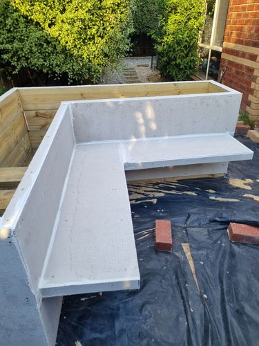

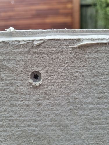

Latest status is all cladded, apart from a little lip I'll do on the inside top of the planter and just finished with the no more gaps 😊
The only query I have is most of the screws are sitting quite flush with the cement sheeting, so can't really be covered over unless I drive them in further but risk going too far or snapping the sheet
Planning to get some painters advice on Monday on whether I can just build up the layer of dulux exterior texture primer and the 2 top coats of the dulux exterior medium texture thick enough that I won't need to worry about the screws and can just paint straight over the top with the dulux products.
Any thoughts on this?
