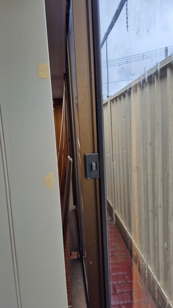

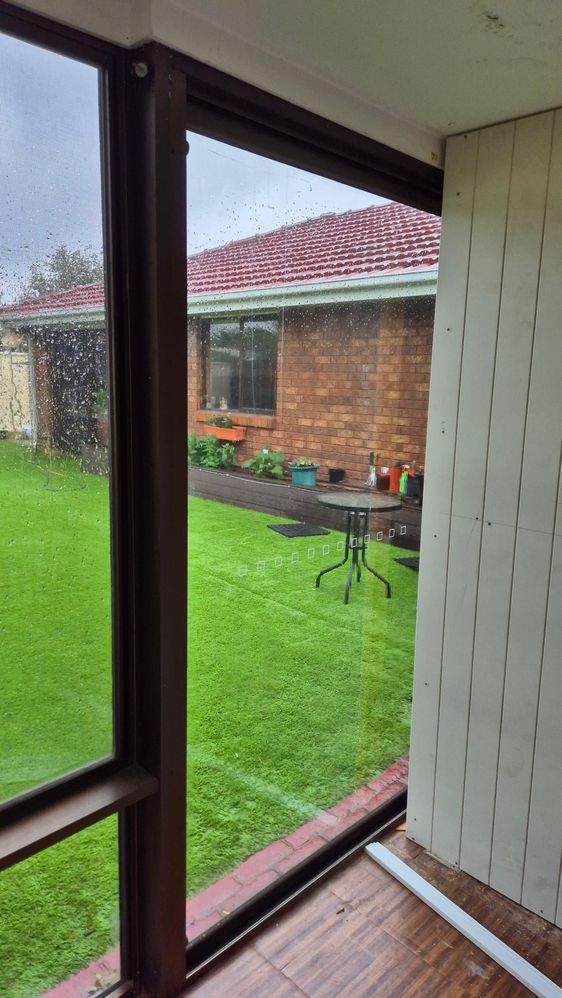

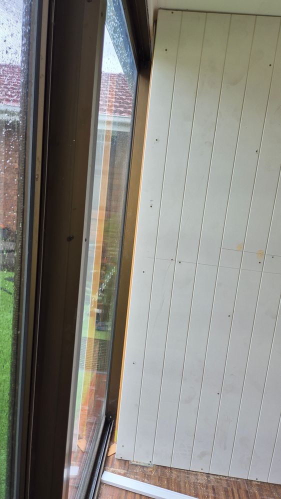

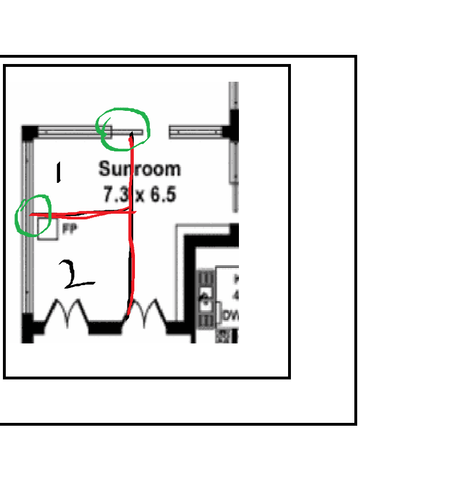

I’m working on converting my sunroom into two semi-rooms
and have completed about 60% of the project. The basic structure is built with timber and 2400 x 1200mm 9mm White MDF Primed VJ Panels from Bunnings.
One of the walls is a glass window, and there are some gaps between the glass and where the panel ends. Similarly, there’s a sliding glass door causing another gap. I’d like to close these gaps as I’m planning to use this space as an office with a portable aircon.
The green circles are where I am seeing those gaps. I don't want to cut the aluminum panel where the glass windows are installed.
Any suggestions on how to seal these gaps effectively?

Hi @xsatishx
I would pull off and extend the VJ panel out towards the glass with cut outs over the aluminium window frame so the panel is3mm off the glass.
I would then use a strip of 5mm thick white or black door sealing foam (usually used around door frames self-adhesive) between VJ panel and the glass.
Where the sliding door is sliding past maybe rubber strip is not foam

Hi @xsatishx,
To seal the gaps around the glass and sliding door, you’ll likely need to construct a customised timber frame to fit these areas. You can use trim work to create a tighter fit around the gaps. A sealing strip can be added between the timber frame and the glass to reduce the gap further and provide a more secure seal.
However, a word of caution: when working around glass, it can shatter easily if knocked or stressed, so make sure you take safety precautions. I recommend wearing appropriate personal protective equipment (PPE) such as cut-resistant gloves, safety eyewear, a long-sleeved shirt, trousers, and enclosed shoes to prevent any accidents.
