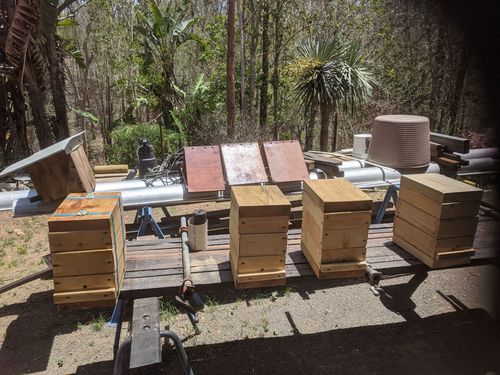

Based on the OATH principal from plans on the web. Used 35mm thick pine (90x35 and 70x35 F12 studs and 50 thick pine sleepers from Bunnings, all planed and thicknessed).
Mitred corners and stainless steel screws for fixings. Propolis smear for attractant and strapping from the B store.
Mini orb roofing and painted ply supports. Just sold one for $20, enough to cover cost of materials.😄

@cadsman Great project! Can I ask, as someone whom makes solitary beehouses, I often get questioned about the use of treated pine from the pallets I make them from. Do you have any concerns about the use?
Re: native bee hives. or OATHs
Two things Mitchell, i would not use any treated timber for native bee hives. I have been told by the experts at a seminar on the tiny ones.
I also would not use pine any thinner than 35mm thick. To use less won't provide the temperature insulation they require to be happy. Just what I've learnt from some very experienced others.
Cheers, IanK.

I use 12mm ply, heat treated & waxed on the inside, for my hives. Also hives are kept in the cool shade and they have gone crazy in their gathering at an average 80 bees a minute returning to the hive. I have been using ply for about 40 yrs, but I am looking at using solid timber of 20mm in my next lot of boxes.
Hey Greg,
I always try to use 35mm thick solid, untreated pine timbers for my OATHs. It gives a greater insulation value than thinner timbers. The insides of the oaths are also scattered with melted Propolis as an attractant for the little buggers. The small blow torch is a great way to melt and scatter the Propolis!
Good luck with the ply and I hope all goes well.
