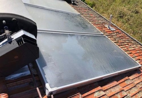

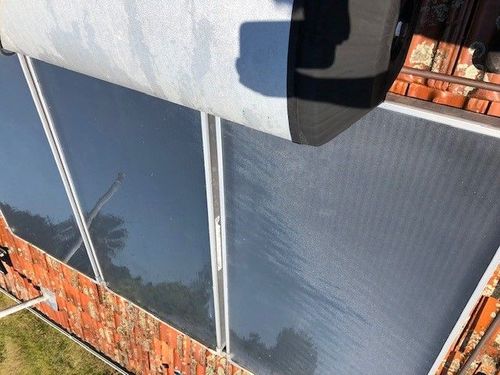

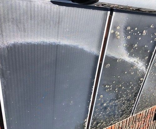

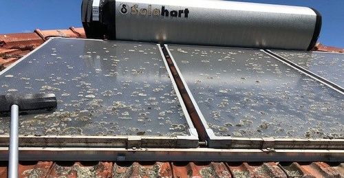

Finally got up on the roof this weekend and cleaned the panels as it was clear it was only going to get worse, not better. Pretty happy with the results. Might get up again next weekend and give the panels a once-over with a microfibre cloth just to make sure there's no smearing left.

Re: Mould on solar panels
The 'mould' shown on the photos looks the same as that on the roof tiles - it is Lichen. Used to live in Canberra where lichen on tiled roofs was common - people would install line of copper wire on top of roof and water running down roof would carry minute amounts of the copper down the roof and slowly kill and remove the lichen. Seems to me that installing copper wire on top of the panels would provide the same result. Probably wouldn't suggest it for those houses that use tank water even though the amount of copper would be minimal. Could also consider washing with a weak mixture of copper sulphate and water.
