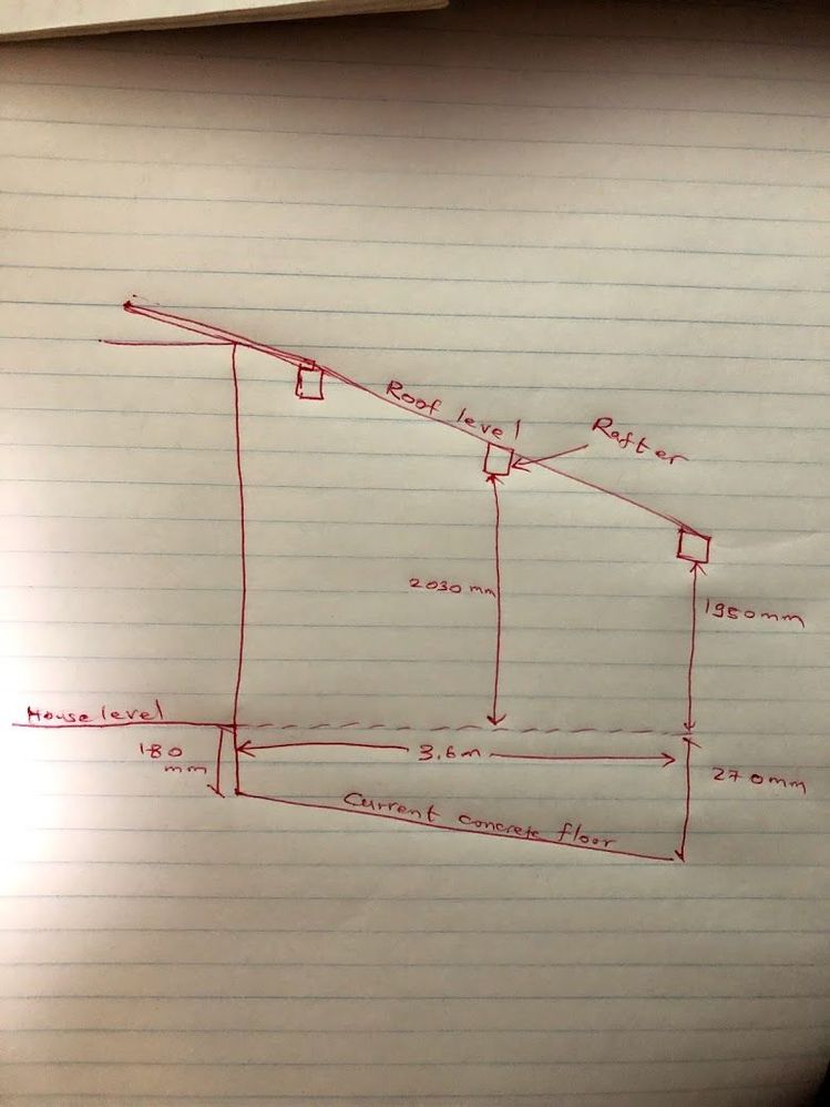

my outdoor entertainment area is currently concrete floor sloped with a drop of 180 mm from house level. Attached is the rough cross-section drawing. I prefer to go for the deck finished level same as house level, however, this will allow a floor to ceiling height of 1950 mm at the outermost rafter level which is too low.
Thinking of dropping the level by 100 mm to allow 2100 floor to ceiling height at the middle rafter level ( I will still only have 2050 mm for the outermost rafter level). But, then the clearance for substructure will only by 60 mm (80 mm - 20 mm decking material) at the house entry level. I am seeking a suitable substructure plan for my decking project.

Welcome to the Bunnings Workshop community @Amin88. It's fabulous to have you join us, and many thanks for your decking question.
With 60mm to work with, you'd be looking at using 90 x 45 H3 Pine on its 90mm face. So, it will be 19mm for decking, 45mm for joist and a 16mm gap underneath for airflow and drainage. Since you'll be working with a sloped slab, the use of Builders Edge Pedestal Feet would be ideal. They are easily adjustable to suit your slope.

Thanks @MitchellMc for your prompt reply. I never heard of laying 90 x 45 by the face of 90 mm. Having said, it’s a viable option for me. What would be spacing of supporting the 90 x 45 you reckon? Also, I’m planning to lay the decking parallel to the house. The length of the area is 9 m. Thanks in Advance!
Re: Low level decking construction
Generally, it's best not to lay timber on its face as it doesn't have as much structural rigidity @Amin88. However, there really isn't enough room to build the structure conventionally close to the house in your case. I'd suggest that the joists should be supported at least every 700mm, and they would be spaced 450-600mm apart.
Once you move further away from the wall and the height allows, you could switch the orientation of the joists to be sitting on their 45mm side. In fact, when you get to the outside of the concrete slab nearing the 270mm mark, you'll need to switch to post supports as even the largest pedestal foot will run out of height adjustment.

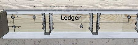

Thanks @MitchellMc . I will consider the 45 mm timber in this case for structural stability. With bolts, I thought of using the bolts exactly same as dynabolt. Driving the bolt through the timber and into concrete floor (like how they connect the ledger using the bolts in the attached photo) after fixing the height using shims.The bolts will be countersunk into timber. I prefer bolt instead of dynabolt because it can be removed later. Please share your opinion.
