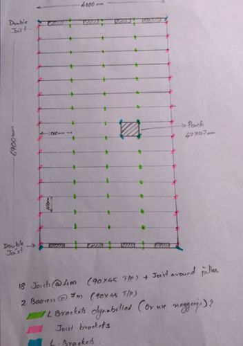

In the article they recommend using a bearer bigger than joist. Am I OK to use the same 90x45mm T/P for my Joist & Bearer? If I dynabolt the joists to ground using the L brackets, do I need to use them on both side of joists? I'm also considering options using noggings every 1m instead of dynabolting the joists to ground. I will also use double joists on the sides for added strength.
90 x 45 treated pine is fine for the joists and bearers. In this low-level deck, you are not using the bearers in the traditional sense of bearing weight. They are simply finishing off the end of the joists and the L brackets are bearing the weight.
You'll only need to use the L brackets on one side of the joist. However, I would advise alternating the side of the joist that you fix them on. In your plan, I would put the two end brackets on the left-hand side of the joist and the middle bracket on the right-hand side. This will help stabilise the joist and stop it trying to pull towards one side.

"In your plan, I would put the two end brackets on the left-hand side of the joist and the middle bracket on the right-hand side. This will help stabilise the joist and stop it trying to pull towards one side."
Did you mean to use the two L brackets on the left side end of the joist to bearer and the joist bracket on the right side? Which L brackets you recommend here?

I would advise alternating the side in which you place the L brackets as per the picture below. This L bracket connects the joists to the concrete. You have them illustrated as the green marks on your plan.
