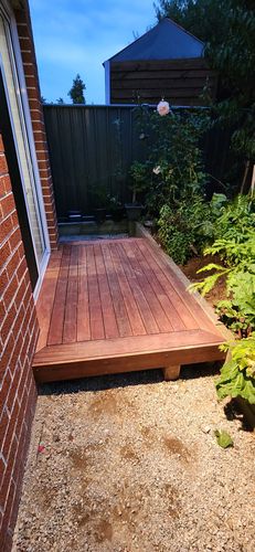

Finally able to provide an update and some final pics of the end result!

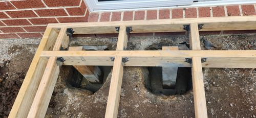

I had no trouble digging 5 of the six holes but due to the location of the deck, the concrete holding up the garden wall post was in the way, and there was a French drain style pvc pipe very much in the middle of the pathway filled with scoria, absolute pain to dig out, very lucky I was able to fit the last post snug in between!
I positioned the deck with additional supports and secured the posts to the deck frame so they were floating in the holes and filled them up with cement.

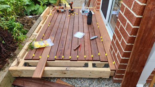

Here are a couple of in progress shots
Here you can see I had to move the post location however it doesn't compromise the structure

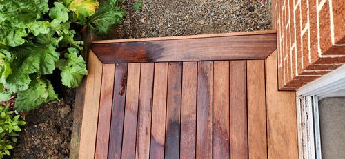

one thing to note that although I used high quality fixings for the merbau that are self drilling, straight shank, I noticed that if I pre-drilled and countersunk the holes slightly there was next to no fibre tearout around the screws for an even tidier look!
And finally the finished product. The decking part was fun, trying to get them dead straight was a slow task but very rewarding! And the final product looks even better than the design!
