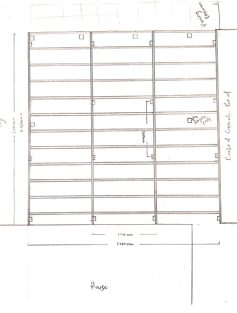

Low level deck - feedback on sketch
Hi All,
Just after some feedback on a sketch for a low level deck. We're looking at a deck approximately 5200mm x 5200mm. The area we'll dig out a little to gain some clearance, but currently there's only about 140mm once we remove the pavers.
The sketch uses 4 x 140x45mm bearers with joists of 120x45mm. Any feedback on the sketch/plan would be greatly appreciated. If you need any more information from me, please ask.New Doc 2020-04-29 21.05.00_2.jpg
Re: Low level deck - feedback on sketch
Hi @pastolz.
Your sketch for the low-level deck appears to be fairly spot-on. A concern I had which I have picked up from @ProjectPete is that your decking boards need to be laid in the same direction as your bearers. Had you decided to run the decking perpendicular to the house as per this design? If not you are going to need to reconfigure it.
Where that pergola post is located you are going to need additional joists to nail the boards butting up to it into. Everything else on the plan from looks like it will work.
@MitchellMc Thanks for the feedback, much appreciated, I think I'll draw up a sketch with bearers parallel to the house and put in joists where needed at pergola posts. If I post up the proposed materials list, would you be able to offer feedback on it before I order? Thanks again!
