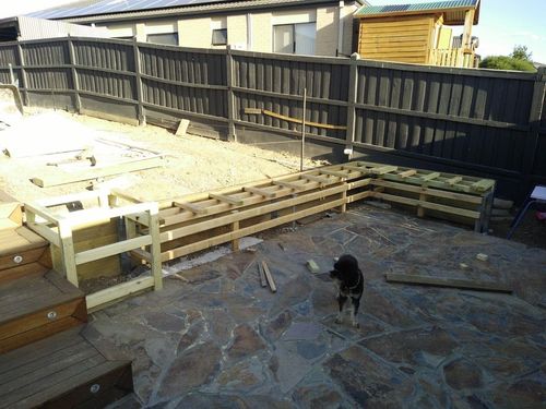

Hi @minimish, I don't really have specs on the build but I have these images. Basically I built a retainer wall as the back wall and used steel for the basic frame then timber from there. All posts concreted well into the ground, blueboard used where I planned to render, and I also lined the planter box inside with blueboard. Once the frame was done, the merbau top was the fun part, and the rendering took me a few coats before I was happy with the finish.

Wow what a terrific job you have done, it all looks great. What is the colour of your concrete and the render on the planter box? I was hoping to put a wider planter box in our front yard have you got any tips on how to do this as I have never done one before? What materials would I use to build the frame and cover it in, do you put the boards on the inside and the outside then render? Cheers thanks. PamW

To create a planter box, I cemented in 4 posts, built a timber frame then lined the inside and outside with blueboard and edge trims. The inside I coated with a rot resistant paint and the outside I rendered using a powder base mixture. Everything was sourced from Bunnings. Depending on the plants you wish to put inside the box and how aggressive the roots will be, ensure the frame is built strong and with no gaps for the rots to creep into.
