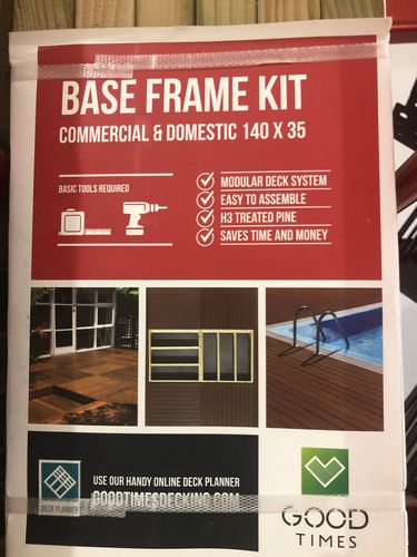

Joining modular deck frame kit
I am about to self build a backyard deck with Bunnings base frame kit. As I need to combine 5 long x 3 deep, what screws or nails would be best to join each completed frame to another and all together.

Fixings guide is here
http://goodtimesdecking.com/assets/how_to_booklet_v5.pdf
It says to join 140 x 35 frames together use 6 14-10 x 65mm Hex Head Type 17 screws.
Search comes up with a list of 4.
To put the frames together 16 14-10 75mm Bugle Head Type17 screws.
For the single frame thickness Steel Supports
If your using traditional fasteners for the deck 10-8 x 65mm Galvanised Countersunk Rib Philips Head.
10-8 65mm Countersunk Philips Head
I prefer square drives as they tend not to slip while fastening. Climacoat instead of galv.
Hope that helps.

Thank you very much for the helpful information
