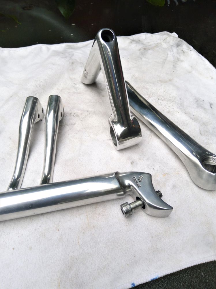

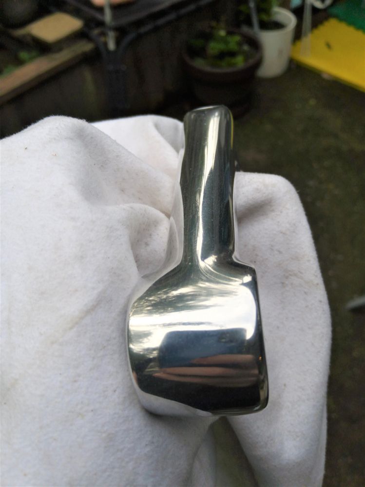

Would you mind sharing some images of the troublesome areas? I've been doing a ton of aluminium polishing lately and I'd be keen to take a look at what you're trying to restore. The aluminium pieces below are all over 30 years old, were heavily tarnished, scratched, corroded and generally looked horrible. Mainly working with wet'n'dry sandpaper, Autosol 75ml Aluminium Polish and a Josco 100mm Replacement Buff Polishing Kit I've restored them to this point.
I'm looking forward to assisting you further.
Beautiful work Mitchell, can I ask if you coat it with anything to maintain or will that require regular maintenance polishing?
