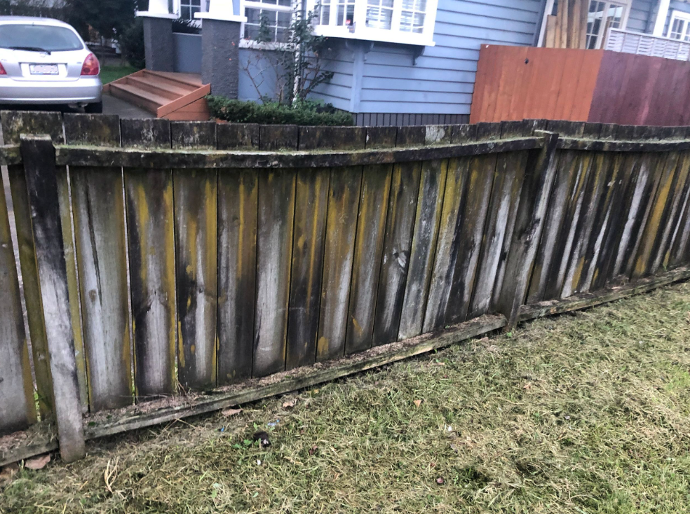

How would you repair a sagging rail and paling fence without having to dismantle it?
Peterg
Re: How would you repair a sagging rail and paling fence without having to dismantle it?

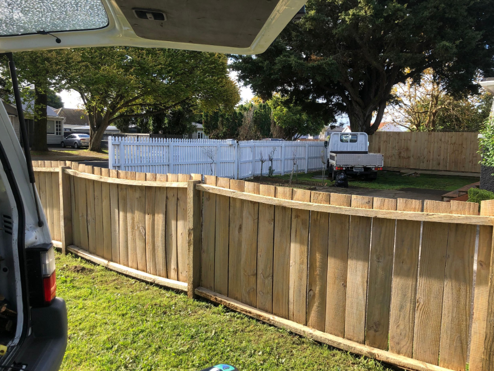

Hi Mitchell
Here are the before and after photos of the sagging fence. As you can see it is in better shape than I thought hence the reason to improve the fence.

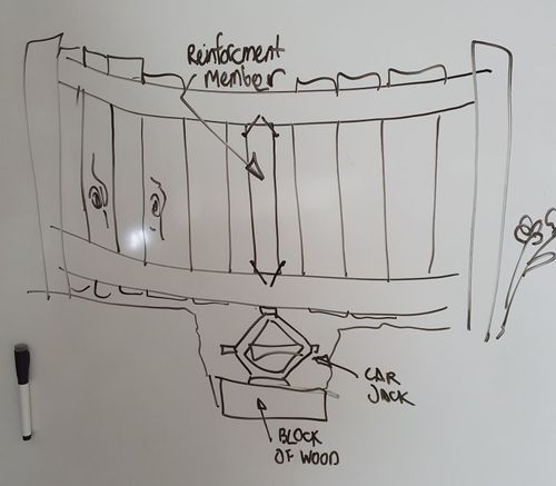

Afternoon @Peterg and @MitchellMc
I was thinking of a hole and a carjack.
It also looks like the grass really is greener on the other side of the fence.
Of course if it works (which I seriously doubt), we need to look at additional steel/wood supports and concrete.
