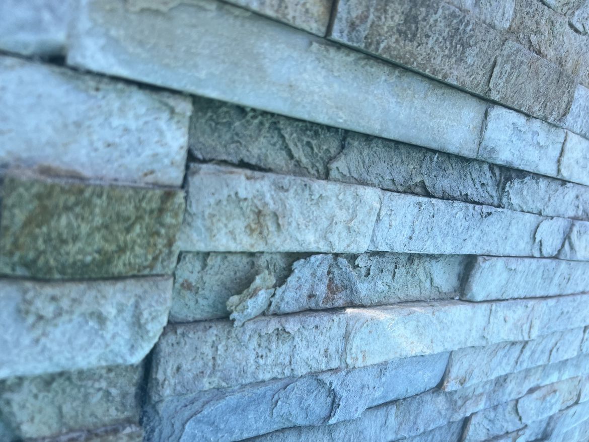

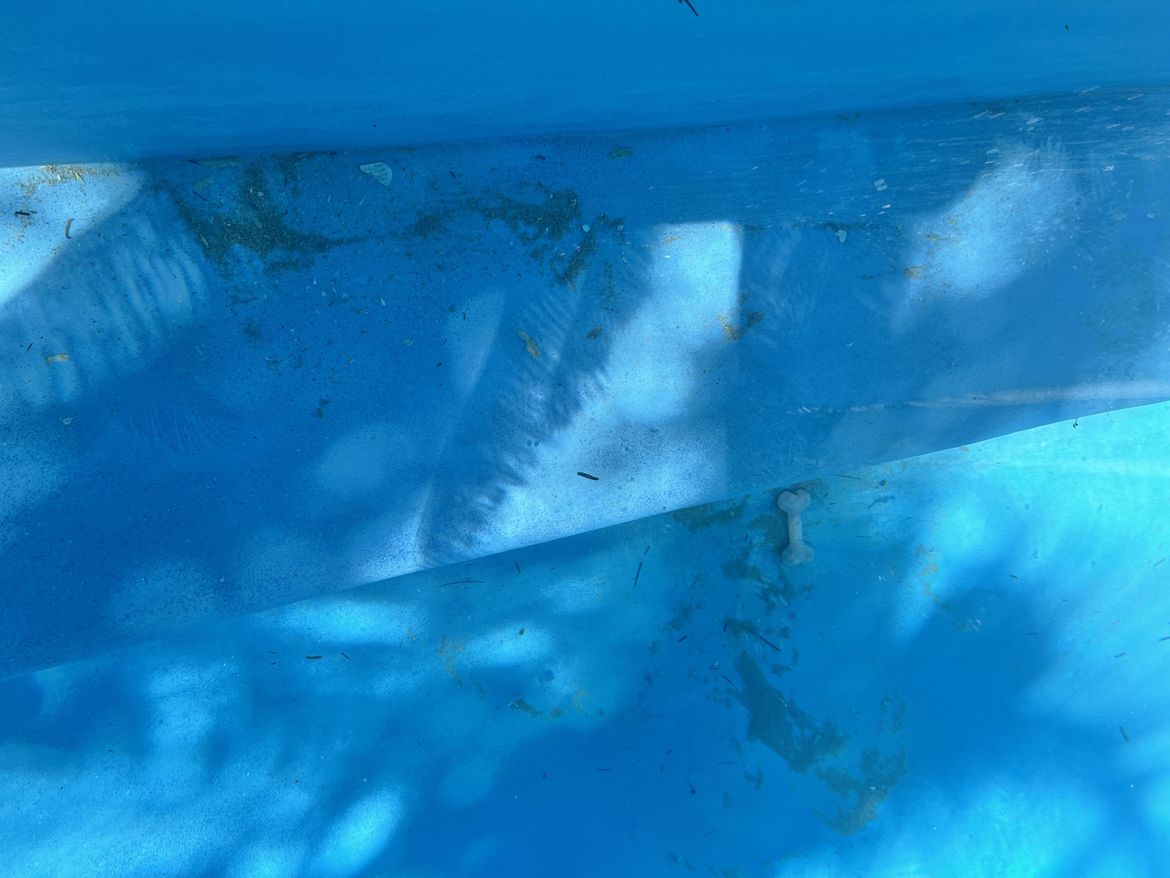

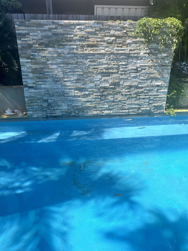

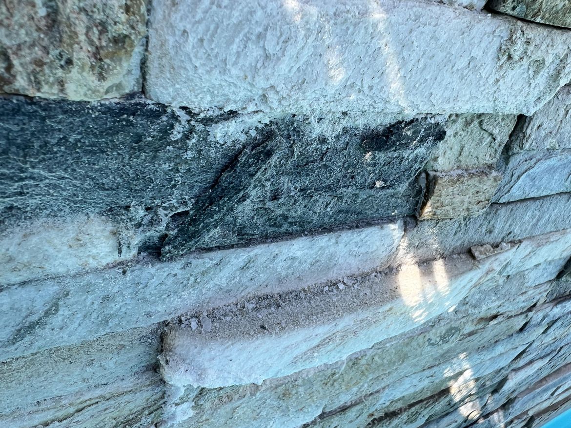

I'm needing advice please. My sandstone water feature waterfall in my pool area is 13 years old and never been resealed. The sandstone is disintegrating and flaking off, which results in my pool having a great deal of coarse and fine sand in it, as well as larger pieces of the sandstone.
There is fine dust covering the feature. Which is the best way of cleaning the sandstone feature without damaging it more? I'm presuming I need to remove all the dust and debris before sealing it?
Which waterproofer and/or sealer should I use? Would it be easier if it was sprayed on, or brushed on? Any advice would be most appreciated.

It sounds like you're facing a challenging situation. Flaking off isn't something I'd typically associate with sandstone, as it seldom flakes. However, the presence of sand particles indicates that it is potentially sandstone or perhaps a manufactured stone.
The first step to address this would be to clean the surface thoroughly. The surface is compromised, so you'll need to pressure wash it and scrub it with a broom to remove loose particles and debris. Even after cleaning, the surface will still be considered compromised, so most sealer manufacturers won't recommend their products for such conditions. If the stone continues breaking down and releasing particles, the sealer will come off with them. The disintegration of the sandstone could be due to exposure to chlorinated or salt water flowing over it. This means any sealer you use must be suitable for a constantly wet environment and withstand salt or chlorine exposure.
I'm not aware of any specific sealer that perfectly suits this application. You could try the Crommelin 1L Natural Finish Penetrating Sealer And Water Repellent, though due to the compromised surface, wet environment and the presence of salt or chlorine, how long it will last is hard to determine.
