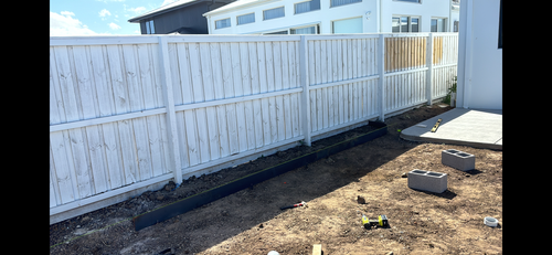

Hello @bow2021
Would it be possible for you to post a photo of your fence? This will give our members a better idea of your fences current condition. We can then make recommendations if it is strong enough or if you'll need new posts for your fencing plans.

No worries @EricL have attached a picture. The fence is brand new, few months old.
we did want to try and extend the height about 600mm as our neighbours windows look directly into our courtyard area.

Hello @bow2021
I propose checking your council rules and regulations in your area in regards to maximum fence height and coverage. Adding a 600mm extension is a lot and could go past the established height rules. It would be best to check before you make any modifications. As a possible alternative, I suggest installing independent posts and using Coolaroo 3.66m Beech 90% UV Heavy Duty People Cover Shade Cloth across the posts.
This will prevent people from looking into your yard but will still allow a certain amount of sunlight to pass through. It's weatherproof, UV protected and can be stapled onto timber, plus it is very light and will not stress the posts you install it onto. I use the same thing on my garage entrance, and no one can see through it.
