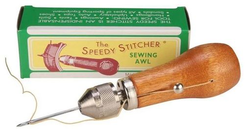

Speedy Stitcher Sewing Awl.
Cheers
hakeae
Cultivating a Following
Re: How to trim shade cloth?
Thanks Alan; I really like these tips. Unfortunately, my sewing machine is still in a box somewhere but I like that awl.
