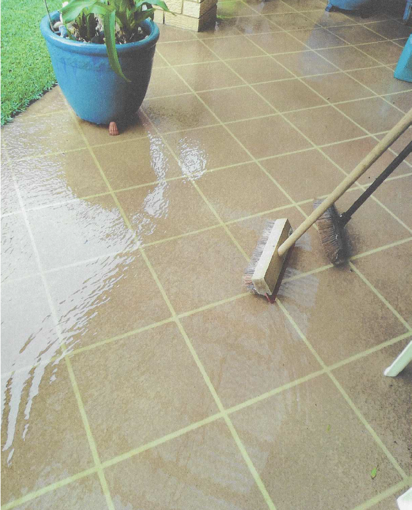

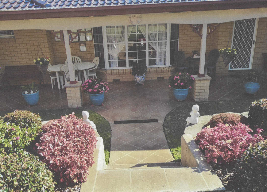

No 1 shows the water still draining  down steps and on back patio.
No 2 shows water still draining and brooms we have use to broom water to the side of the patio so that it will run down the side and drains down the     side to take the surface water.

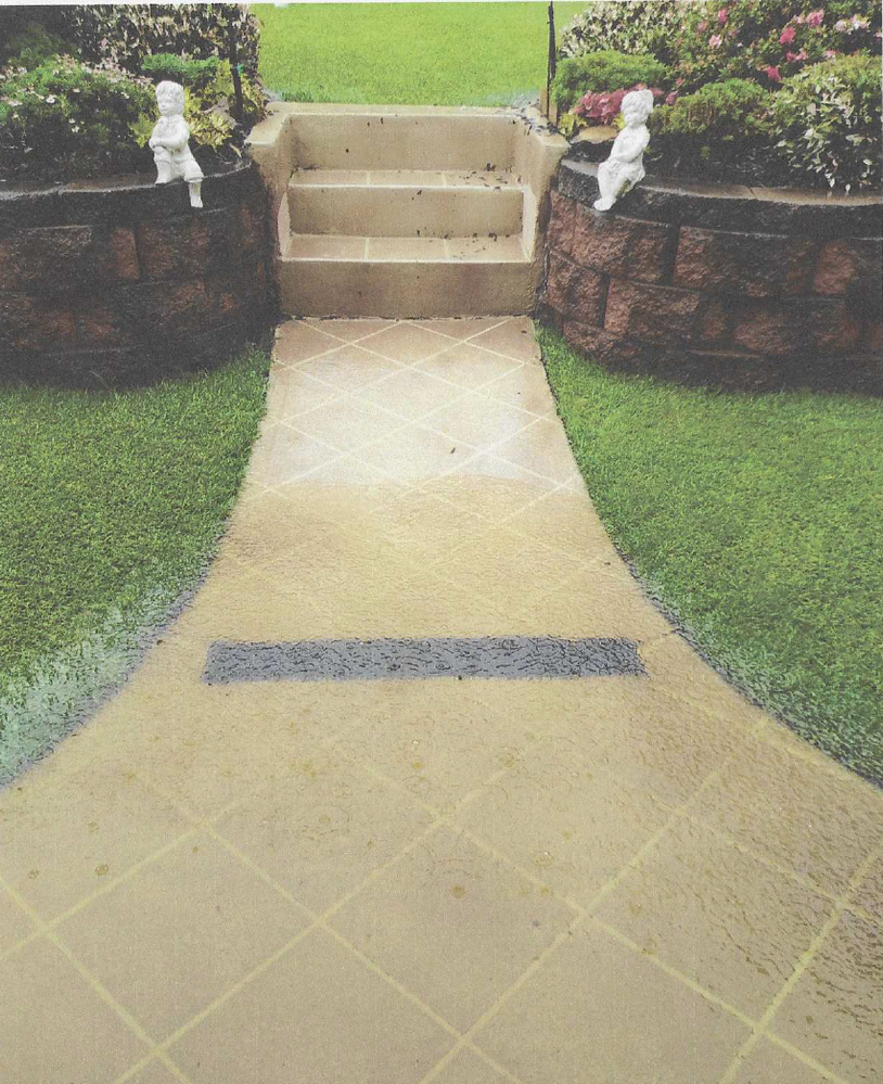

No 3 shows back yard  and lower garden with steps and the back boundary fence garden

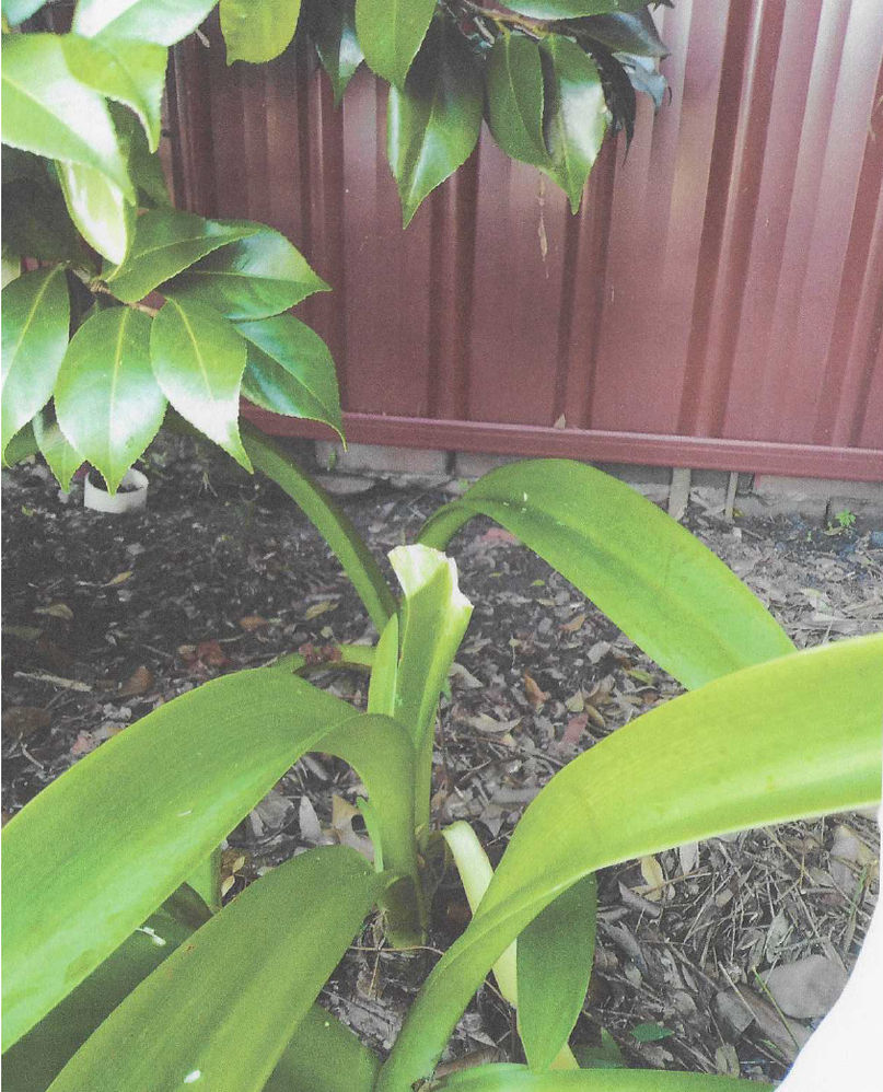

No 4 shows under the boundary fence where the brick wall is . The brick wall does not come under the fence it is behind the colour bond fence.

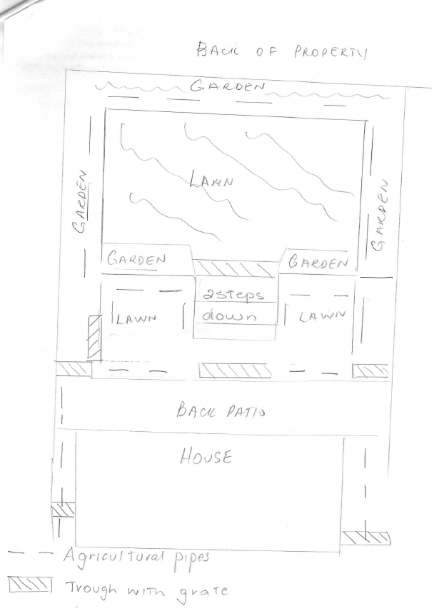

Many thanks for those photos, @Barbara35. They really help paint the whole picture.
I can see from your plan that a significant amount of subsurface drainage is installed all over your backyard. Even at the rear fence line, as I was encouraging earlier. Either the line from this drainage back to your stormwater is blocked, or the stormwater pipe itself is blocked, the grading of the line to make the water flow there isn't sufficient, or the line back to the stormwater is not of large enough capacity. I'd be keen to know where your stormwater line is and how this immense amount of agricultural pipe sends the water there.
I think this is a case of an amazingly well-thought-out drainage plan that hasn't had sufficient lines back to the stormwater installed. This drainage plan should cope with the water from your property and the next doors without issue. It is more than adequate to collect the water; it's just not capable of sending it anywhere. The standing water above the grate indicates that something isn't coping. I would take a guess and say that only one 100mm line is connected to all this drainage and is trying to delivery the collected water to the stormwater line. If this is the case, that's the point at which you need to run additional lines or increase the diameter of the pipe.

The pictures sent was after the flooding had stopped and this was the last to drain. In the video you can see how the water runs over the brick in the back and this is only after it has drained enough to be lower than the brick wall.
The ag pipe around the back fence down the side across the middle into the storm water which runs down the side of the house and out into the street is 100ml. Without the water coming from the property behind we do not have a problem. We know the ag line at the back works because if we over water then it runs out of the storm water into the street.
The reason that the water cannot get out is the volume of surface water coming through the back property it goes straight over the ag pipe over the garden and into the backyard. Floods the top level and rushes over the bottom garden and steps. We can not stop it we just have to broom it away to the side as fast as we can which is not easy.
The standing water above the grate is after water has drained and the flooding has stopped.

Thank you for posting those photos of your lovely backyard. The quick solution at the moment is to put up a rectangular wall of sandbags in your back patio area. This will prevent the water from accumulating in that spot when your lawn at the top starts to flood. You can at least relax a little bit as the water will not gather at the patio doors.
I suspect that there is a slight slope in your property with the way the water is flooding after the steps. Another possible cause of the water from not draining away is that the street drain is actually flooded as well due to the amount of water running through it from the neighbourhood. Since you've already spoken to the local council, I suggest holding back in doing any major plumbing projects until you get a definite answer from them.
Should another strong deluge occur, I suggest taking videos of the flood from its point of origin at your fence to the bottom area where the water is flowing to. I'm aware that you've spent a great deal on your drainage system, but I'm afraid that it is just not coping. I suggest speaking to a registered plumber and getting a quote on how much it would cost to modify the existing drain system to accommodate the large amount of extra water coming from your neighbours.
