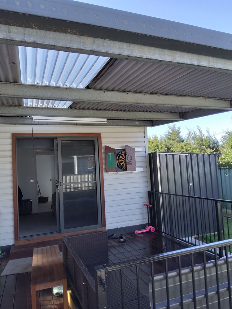

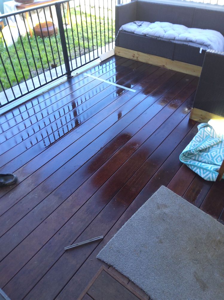

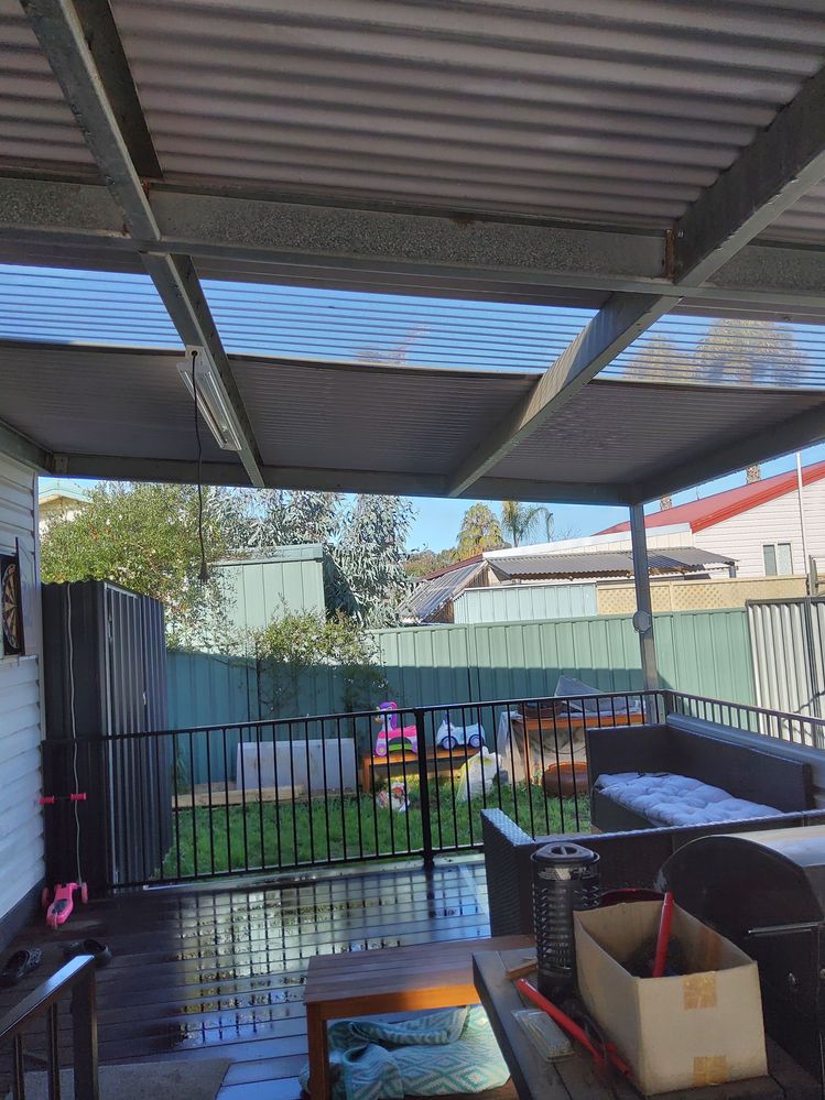

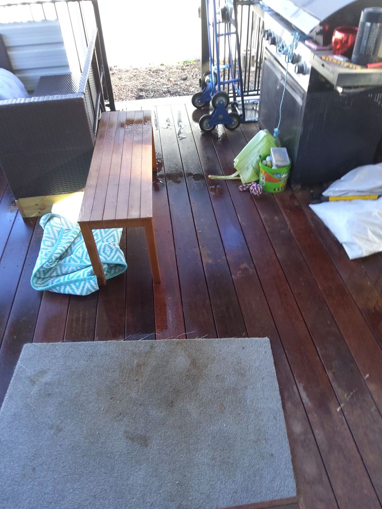

How do you fix the problem of condensation dripping onto patio i have single sheeting colour bond roof see pictures

Condensation on the underside of a Colorbond patio roof is fairly standard and experienced by many people. I know mine drips during this time of the year. The only real solution would be to insulate and clad underneath the roof to prevent moisture-laden air right at the due point from coming into contact with the cold. I suggest checking out these discussions on the topic as we talk about solutions quite extensively: How to stop condensation on a patio roof and How to insulate a metal roof?
